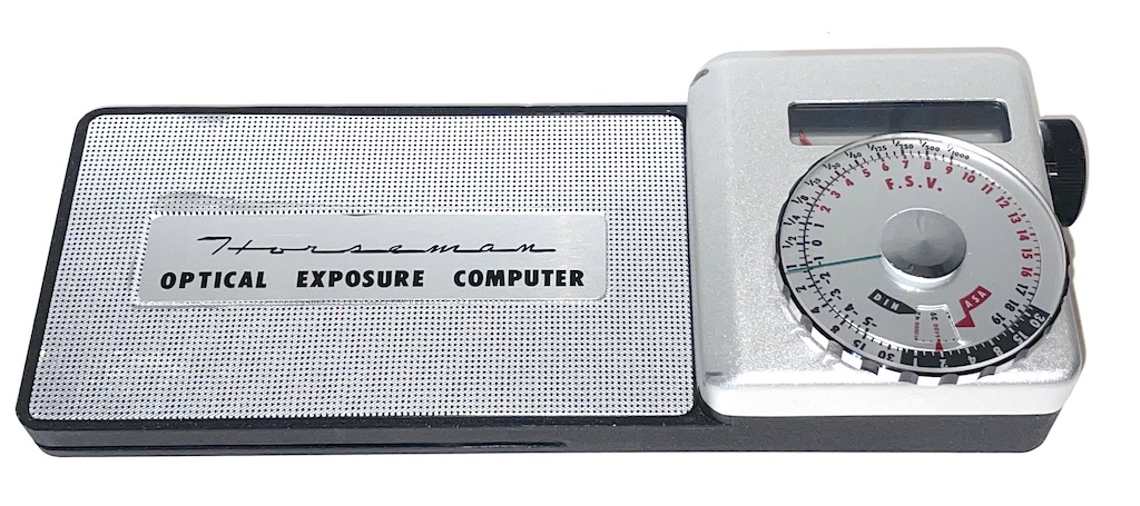

I may have to re-think the voltage regulator as it needs to be used on a device with a negative ground. The Horseman Exposure meter has a positive ground. That means, the voltage regulator would need to be inserted between the battery and the end cap.

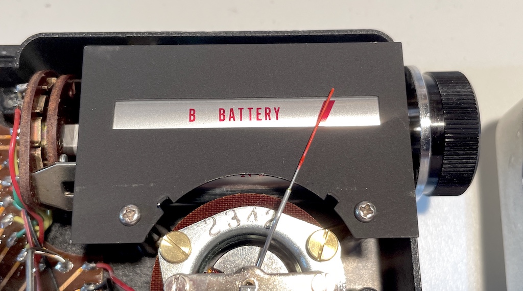

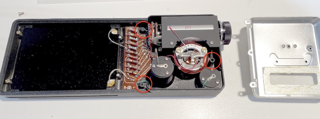

I have opened the exposure meter. There are 3 screws holding the chrome lid as circled below. I was wrong, the knob did not need to be removed.

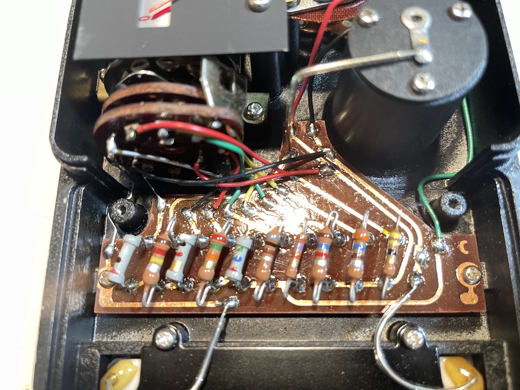

Zinc cells seem to be the answere here, instead of a voltage regulator and a single battery.
