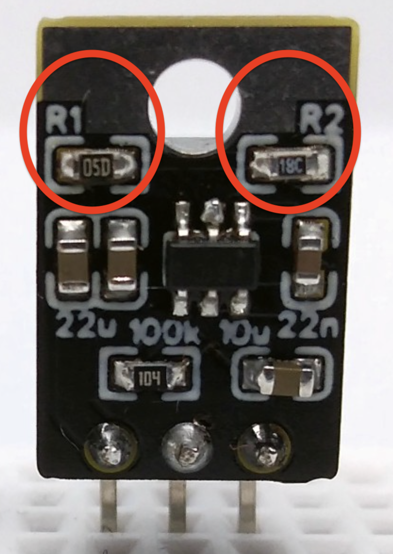

I'm working on modifying a PC board ( link to the regulator ) to output 5.4V for mercury battery replacement.
The issue at hand is the PC board is using SD8942 with two resistors to set the voltage. All fine, but my specific problem is as such:
I'd like JLPCB to make the board and install the resistors. To do this I need to locate the two resistors they have in stock in the correct size and put them in my EasyEDA project so they can install the resistors when they make the board.
The equation is: R1 and R2: V = 0.6 * (R1 / R2 + 1)
I need to make it output 5.4V

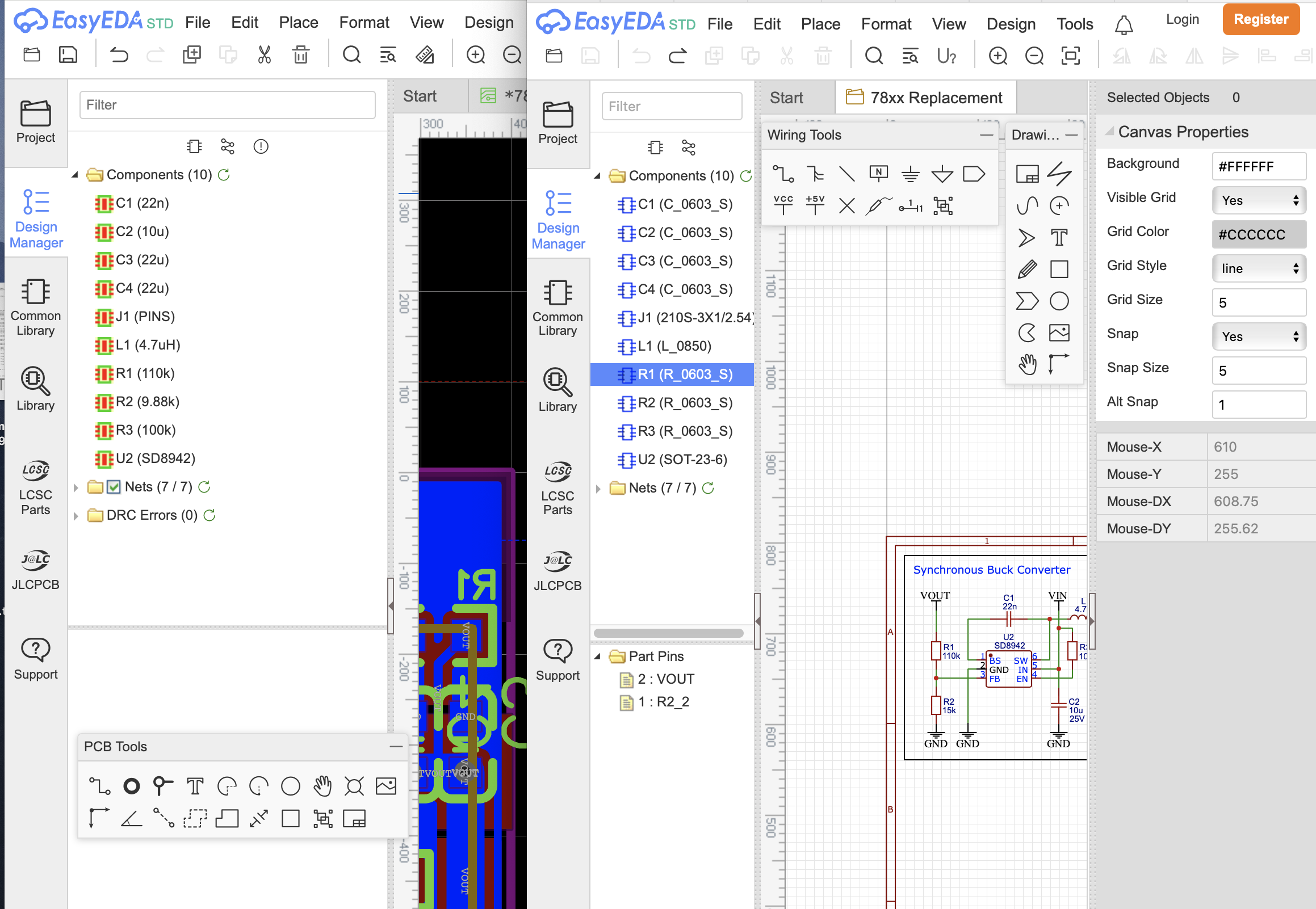

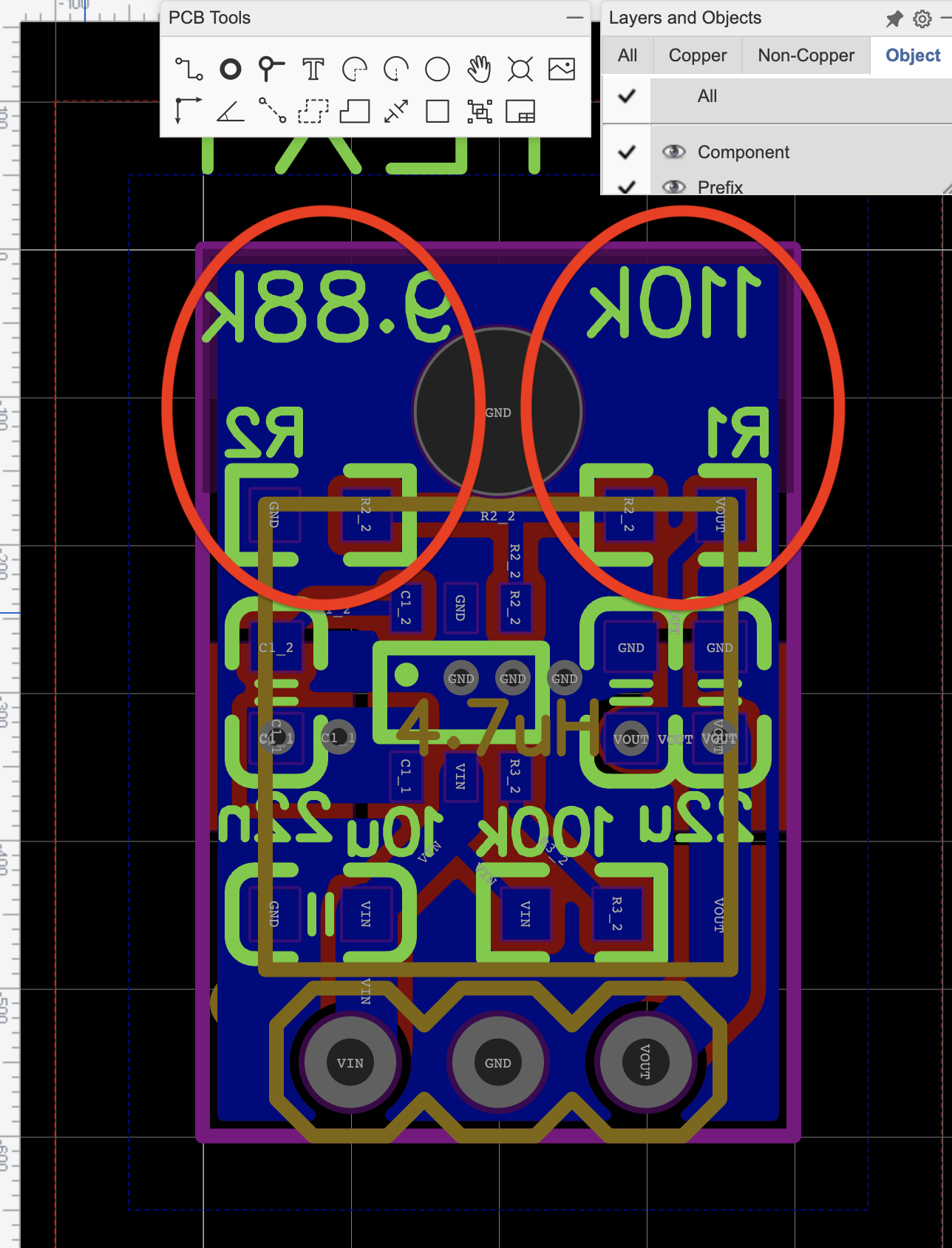

This is as screen shot of the original file in EasyEDA. Maybe it is just busywork, but I'm having trouble locating two appropriate resistors via the software.
Also, something as easy as changing the sliksreen so it no longer reads (88.9k and 110k) I have found frustrating.

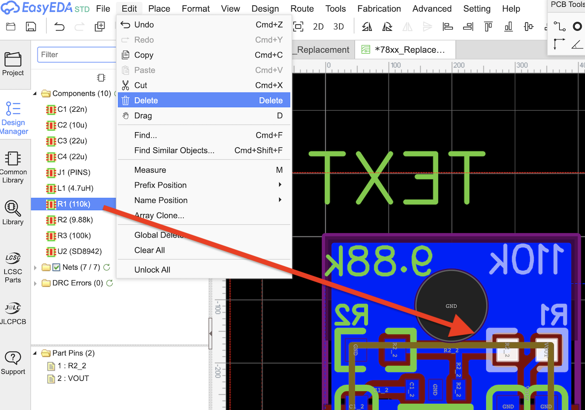

Having the board made with no resistors in those slots is an option too. However, right now I can't delete the components from the project.
I did find out that the Library components (mentioned in post #3) show items not available and is not very useful.
The work-around is to search directly from JLCPCB for 0603 resistors in-stock and find the JLCPCB part # and type it into the Library search box. From there, one has access to a "Place" button to put the resistor where it needs to be on the layout.
However, as mentioned above, I can't seem to delete the existing resistors.
The Delete function here does nothing. I am getting closer, however.
I don't think you're supposed to.
The logic of most EDA suites I've used is that you use the schematic capture to select and connect components. Then in the PCB layout you do the physical routing. This means that any changes to components or nets should be done in the schematic capture, and then cascaded to the PCB layout. I've not used EasyEDA much, but I suspect this is how it's supposed to work there as well.
So, I'm 99% there. I have added the 120K and 15K resistors to the diagram. All I need to do is move them over to the correct locations after deleting the components (R1 and R2) in those locations. Can't seem to do that at this time.
Excellent, I did find the schematic ( on this site ) but it opens in a separate window. I CAN delete the resistors in the schematic.
Now, just to find out how to combine the schematic and the layout in EasyEDA...right now they are in two separate and unrelated windows.

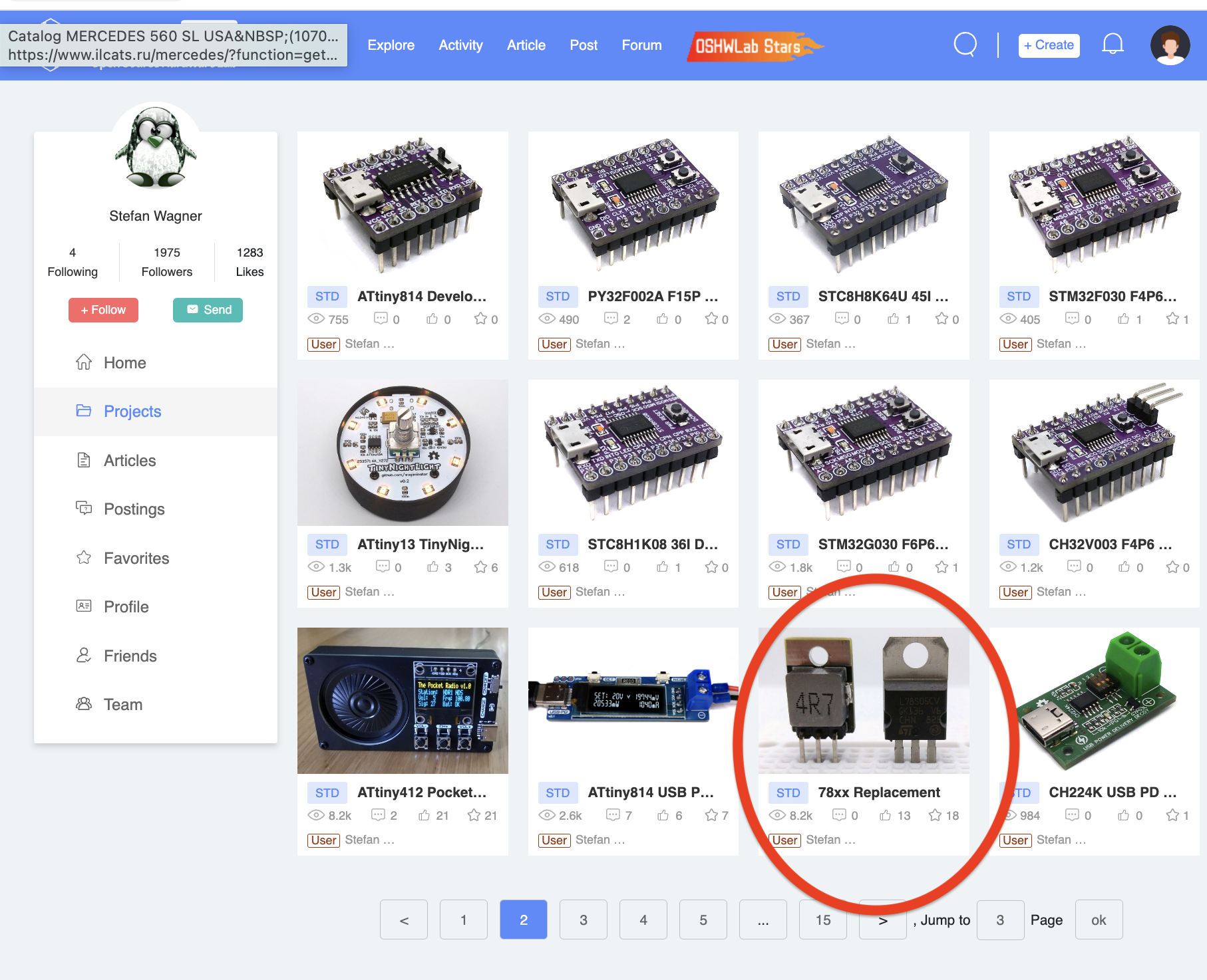

Looks like the designer has posted over 150 open source projects all with with EasyEDA file, schematics and BOMs, so I suspect he knows the software pretty well to help me, if he responds.
