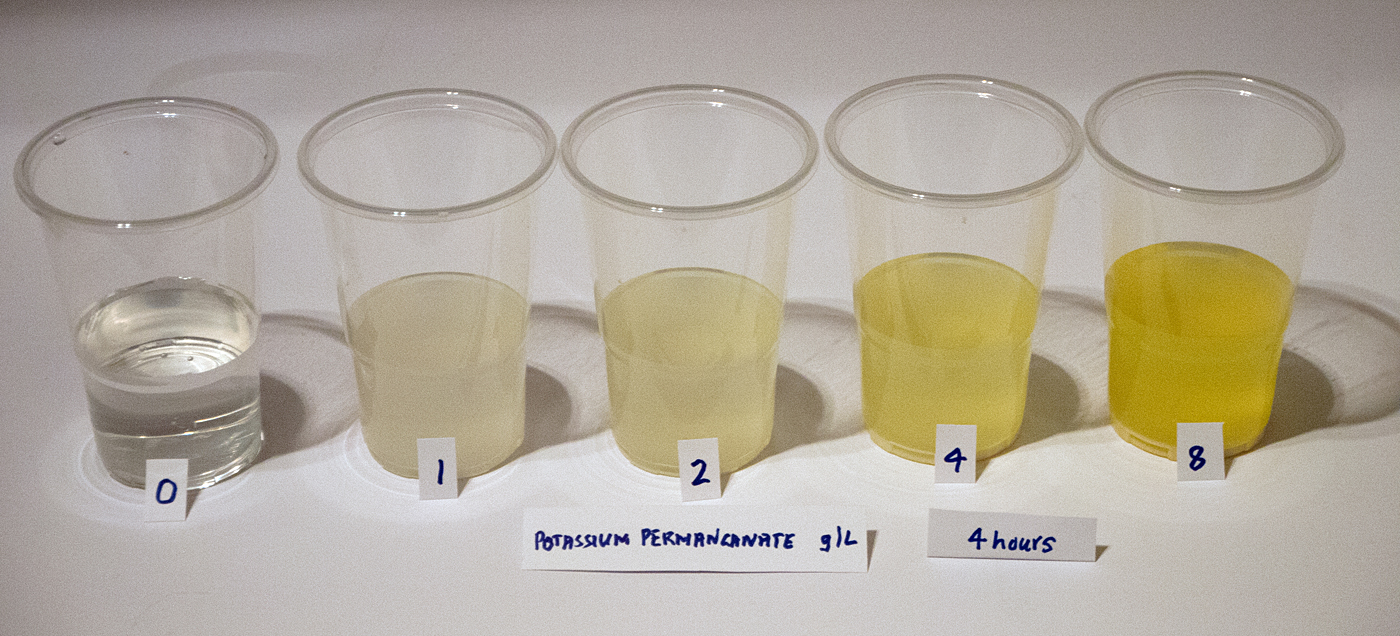

I repeated the test done for the orange color, except I added sulfite. Bicarbonate not carbonate buffer was used to give a pH similar to that of solvent ascorbate/sulfite developer.
The solution was now Sodium Ascorbate 10g/L, Sodium Bicarbonate 30g/L, Sodium Sulfite anh 50g/L.
When potassium permanganate solution was added there was at first a brown precipitate, presumed Manganese dioxide, equation in post 52, but this soon disappeared to give a yellow colored solution and a white cloudy precipitate (not identified).

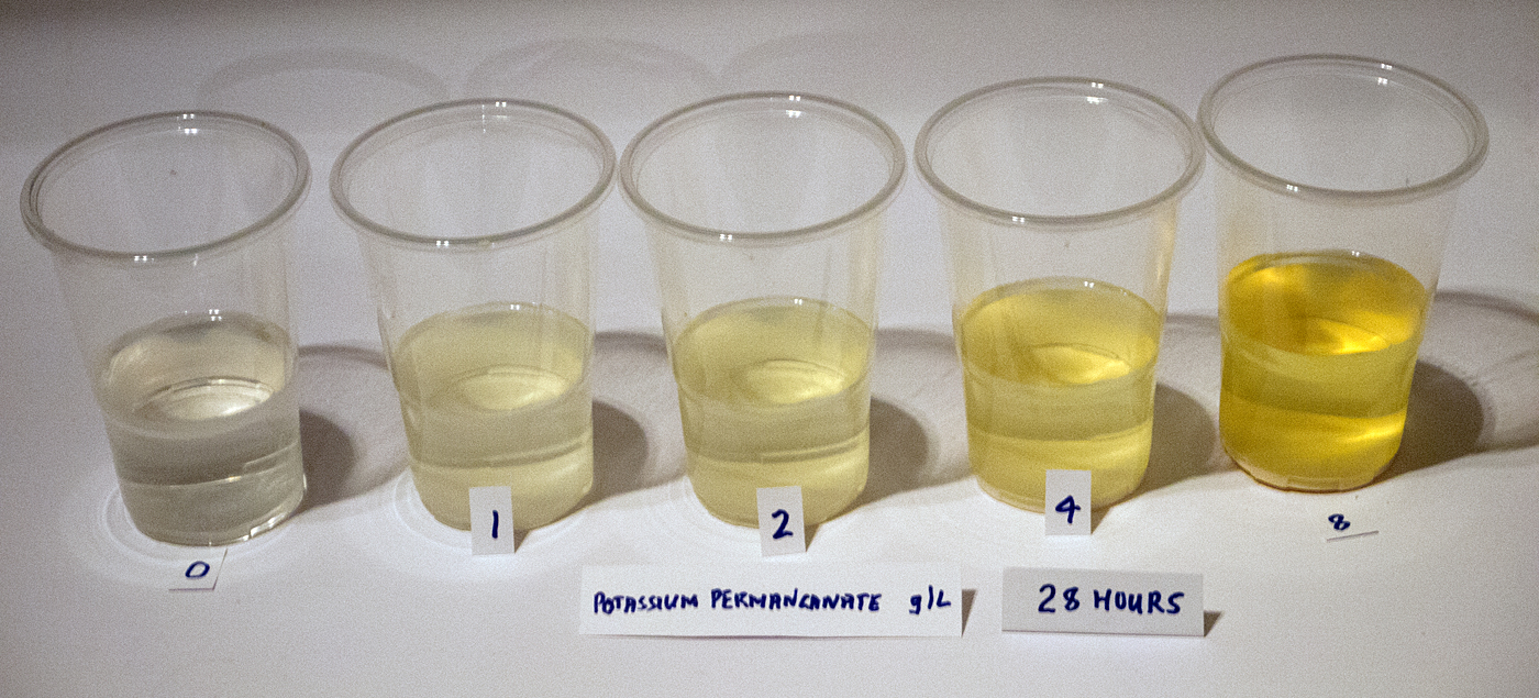

The yellow color was deeper with more permanganate added, which may simulate progressive change with time for the oxidation of ascorbate/sulfite developers in air.The yellow did not change in depth from 4hr to 28 hr (attachments).
This is my suggestion for the formation of the yellow color:
(1) DHA formed due to oxidation reacts with sodium sulfite to give sodium bisulfite plus sodium hydroxide.
I don't have a reference for this but experimentally the pH of the sample with the highest amount of permanganate added (8g/L) was about 1 unit higher than the sample with zero permanganate addition after 4 hrs.
It may be similar to what happens with acetone/sulfite, eg in Bishop's developer.
(2) DHA reacts with sodium bisulfite.DHA is a lactone and I believe unsaturated on the carbon in the ring connecting to the side chain COH. According to this reference, unsaturated lactones react with bisulfites:
https://books.google.co.uk/books?id...h3vogbO#v=onepage&q=lactone bisulfite&f=false
From this I conclude that the yellow color may be a DHA-Bisulfite compound.
