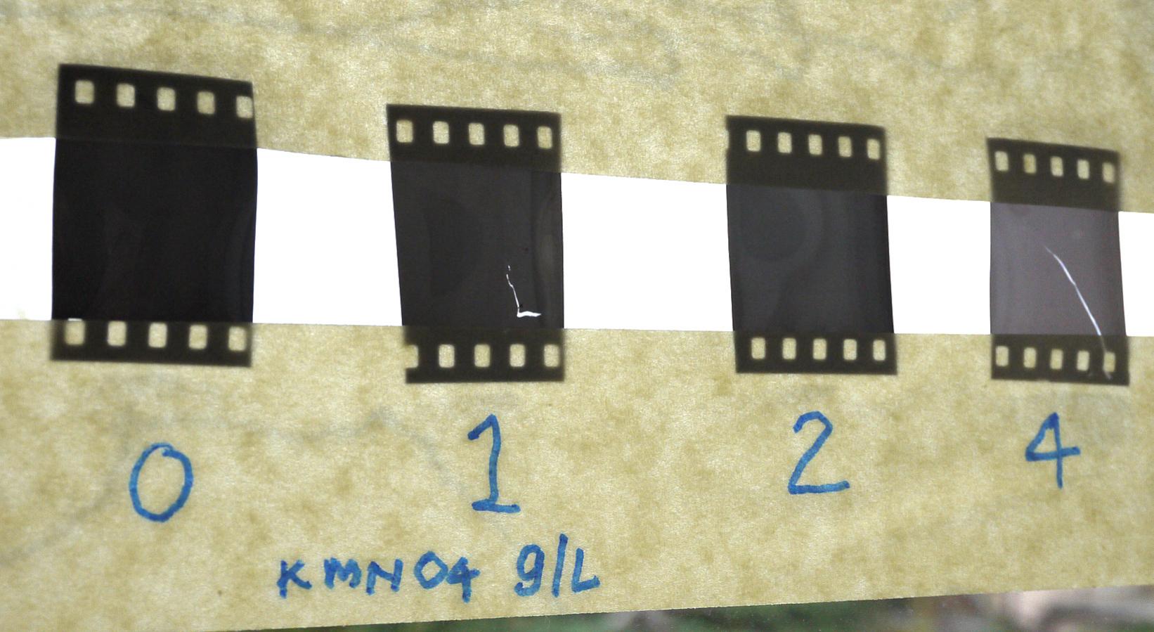

I did try oxidizing the ascorbate/carbonate with iodine dissolved in isopropanol but it appears to coat the film with iodide which takes a very long time to fix so I changed to permanganate.
Attached, a more controlled experiment. 12g/L and 6g/L permanganate are thinner than ascorbate alone.So the 6g/L in particular shows that if DHA provides a developer at all it is less active than ascorbate alone.

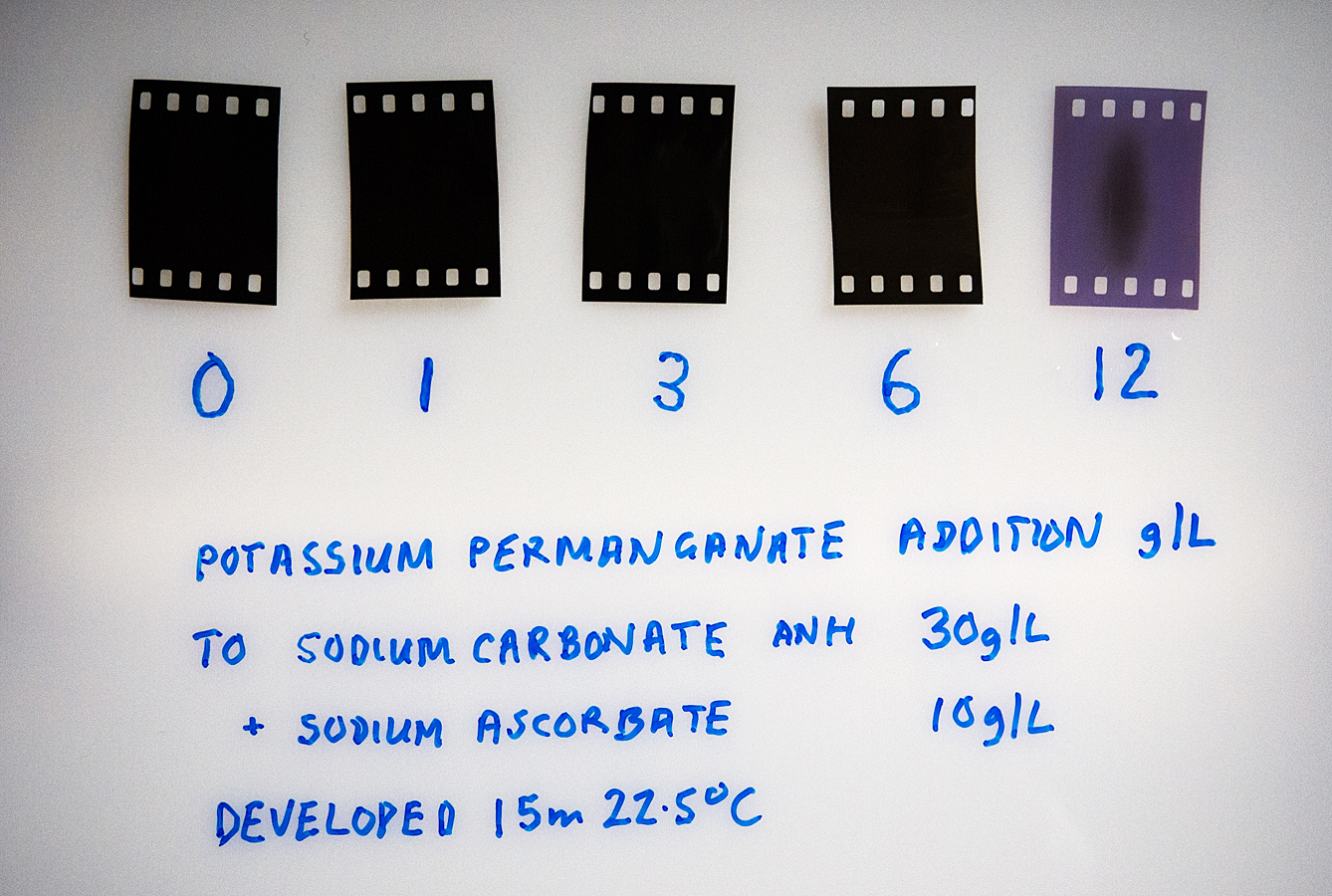

I modified the test to try to avoid any solvent effect of KMnO4.The initial mix of ascorbate/carbonate solution and permanganate (added in solution) was stirred until the purple color was gone (a few seconds) before adding the film and commencing development. The attachment shows the density for various amounts of KMnO4 added to 30g/L sodium carbonate anh + 10g/L sodium ascorbate at 22.5 C for a development time of 10 min. Samples were photographed stuck on a window as this shows density differences better than the previously used lightbox.The KMnO4 additions were 0, 1.0, 2.0 and 4.0 g/L.
The conclusion is unchanged,with better data now.The fall off in density is probably due to the decrease in ascorbate concentration as it is lowered by the KMnO4 additions.
No effect of DHA derivatives as developers was found.

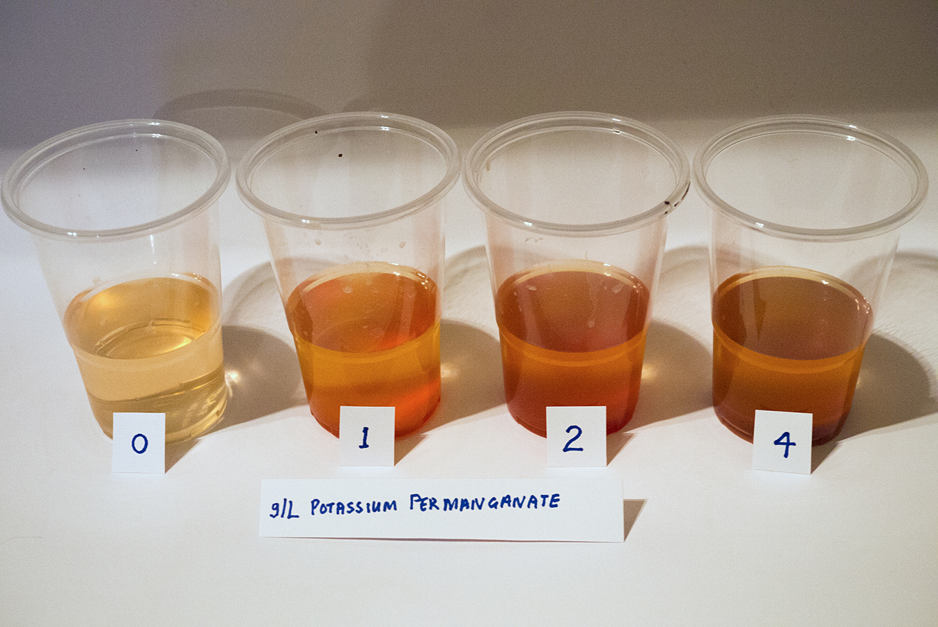

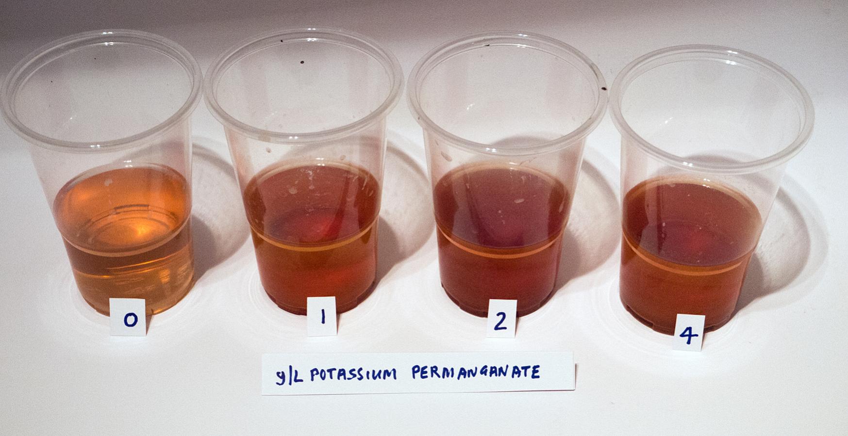

The orange color
Orange is the color to which ascorbate developers not containing sulfite oxidize in air.I noticed that the four solutions of 30g/L sodium carbonate + 10 g/L sodium ascorbate +0 , 1, 2, 4 g/L potassium permanganate started to go orange and photographed them after 4hrs and 28 hrs (attachments DHA 4hrs and DHA 28hrs).
Since these solutions were expected to contain dehyroascorbate (DHA) , and it is suggested in the link from Rudeofus in post 33 p245 table II this will slowly decompose to diketogulonic acid ion, the orange color may be that of diketogulonic acid.
It is known from recent work on ascorbate oxidation in the lens of the eye that other compounds can be formed but I have not investigated further.
