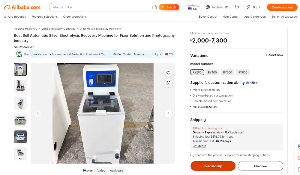

I wonder what one of those smaller electrolytic plater machines cost? Maybe when we install the roboline I'll consider one. With both B&W and C41 going through the machine, should be a decent amount of silver outflow via the used fix.
Alibaba has several small silver recover machines for sale.
US based silver recovery companies don't want to sell you a machine; they want to sell you a harvesting contract and a machine lease. Ironically, they tend to turn their noses up at anyone who doesn't produce thousands of ounces of sliver a month. Claim it's not worth their time; at least that was my experience when trying to get a system for the motion picture lab in which I worked.

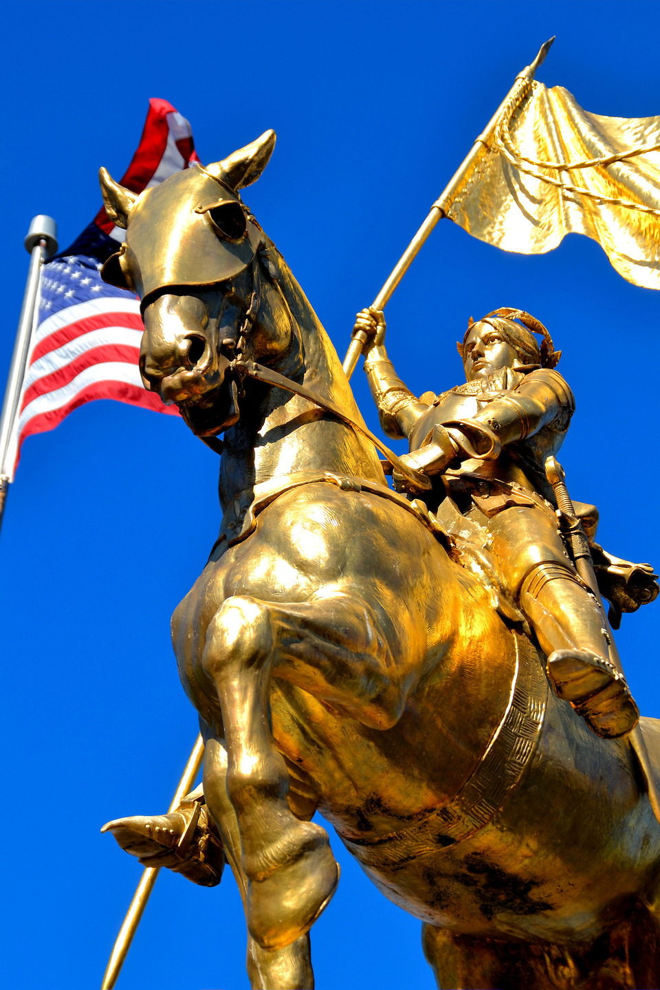

In the 90s, before he started his own business, my father did picture framing work for Gold Leaf Studios... the price of a book of gold leaf was $35. I see it's about 4X now.
The process is interesting, you cover the frame with "Size" which is a yellowish glue, then use what I recall is a camel hair brush to tamp down the gold. He taught me as a teenager but I never quite got it down. After that you smooth and burnish it with various tools.
This was his biggest gold project, Joan of Arc statue, visit it if you find yourself in New Orleans:
