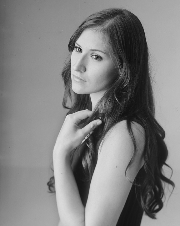

I heard good things about the film. So I thought I'd give it a try with 4x5, this is a scan of the negative. I'm trying to print it with the enlarger on FB Arista paper but my dark's keep blocking and it looks a bit milky.
The Arista.Ultra EDU films are all a little bit slow compared to their rated box speed, regardless of developer. You may wish to try exposing them at about half box speed for more solid shadow detail, and clearer details in those areas.
I found the ISO 100 to work well at EI 50, the ISO 200 well at EI 80, and the ISO 400 well at EI 160. If you use a speed enhancing developer, such as TMax or Ilfotec DD-X, you may get a bit more.
I hope that helps! Beautiful portrait.

Thank you guys I will try shooting it at half box speed. I currently have d76. When I run out I want to try some other types and find my own style. I do want to try stand developing but read its not ideal for printing. Anyone have experience to the contrary?
I shoot Foma and Arista EDU Ultra branded and found that half listed speed in any developer works very well. I have it in 135, 120, and 4x5 formats. My favorite film/dev combo for 4x5 is 100 speed shot @ 50iso in Pyrocat-HD, 1+1+100 for 15mins @ 20c, normal agitation.
I don't think standing development lends much to the Foma films, honestly, but that's just my flavor. Standing development is a pretty extreme form of compensating development, and has its uses and strengths, for sure.
For me, with Foma films I find that the highlights become a bit dull this way, and I prefer intense highlights. The best results I've had with Foma, on the Ilford paper I like to use, is with Edwal 12, a developer that yields brilliant and intense highlights. That gives me the sparkle I desire in the highlights, which to me is one of the best aspects of these films.
But test it for yourself, and print the negs to see how you like it. Compare it to regular development on the same shots. Make contact sheets of the negatives side by side to see the difference. It will tell you a lot.

I feel like a geeky doctor always testing, but I wouldn't have it any other way. It's a lot of fun and ALL of you have so much incite thank you for sharing. Now if I could just figure out how to get a proper contact print from the negatives, I feel my testing would be that much better.
Contact printing is like a luxury compared to enlarging. For my own film and developing testing I use a contact printing frame, but a sheet of glass and a flat surface will do nicely. You lay a piece of photo paper with emulsion side up, put your negatives on top with their emulsion side down, and then you 'close the lid'. If you use a sheet of glass I recommend taping the edges with tape so you don't cut yourself. Put pressure on the glass to hold paper and negatives in close contact, and avoid blocking the light. You can use weights if you need to use your hands.
Make a test strip to determine exposure time, and start making contact sheets. The exposure time that gives you maximum black of the paper in the film rebate is usually the best exposure. Then you either adjust contrast grade of the printing paper, or you adjust developing time of your negative to get the contrast you need out of the print. I always make my contact prints at Grade 2.5, and adjust film exposure and developing time to have negatives that print reasonably well as a straight print at that contrast.
Then when I start making individual prints of single negatives I of course tweak the print into what I want the finished print to look like, but I find the approach above gives me the best starting point to get to a finished print, with minimal time spent and minimal waste.
And keep practicing. Your picture above is really nice, so I think you are well on your way. You just have to remember that your paper and paper developer has a certain range, and your negative exposure and development time are variables that you alter to fit the paper and paper developer. If you learn how this system works, it will be much easier to make negatives that print like a dream without much darkroom gymnastics.
