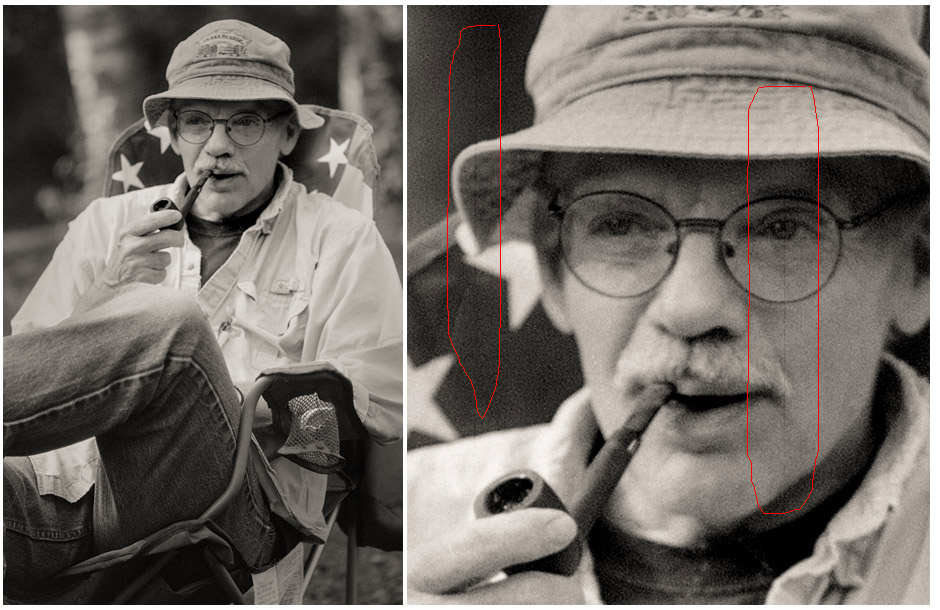

Re: Foma 400 in 35mm - new problem
So I have discovered a type of scratch that travels the length of the film when I use Foma 400 in 35mm.
I have shot the film in a Pentax KX and a Leica M4-P, and alongside the Foma 400 film I've shot Kodak TMax400 and Kodak Portra 160VC. On the Foma film, from either camera, there is a scratch that travels along the length of the film strip, and it's not there on either Kodak film. It doesn't stretch all the way from beginning to end, but shows up intermittently.
See attachment. This is not the Arista.EDU400 version, but the Foma 400 Action in 24 exposure rolls.
I think I'm done with Foma film, unfortunately, because I really love how they look. The 100 is especially nice, but the 400 is really gorgeous for portraits and 'busy' compositions also. Kodak will get my cash from this day on. I can't keep wasting time with it and wondering whether my results will be OK or not.
