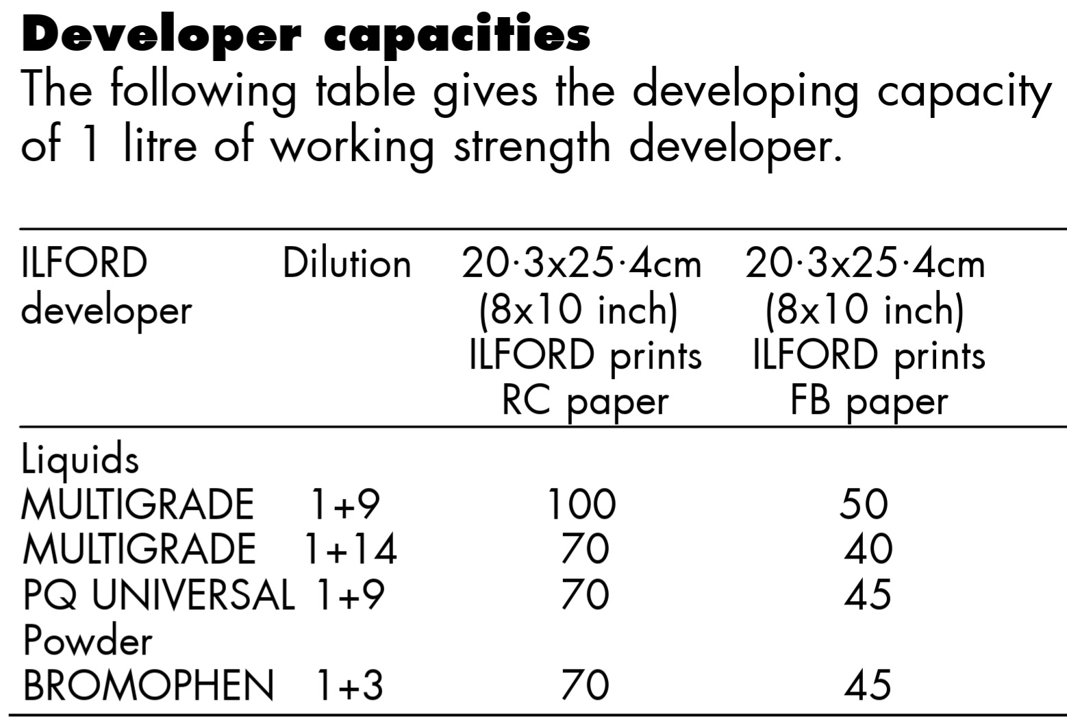

Hardly. You get 10 L of working solution from 1 L of Multigrade (1+9), but 5 L of Bromophen 1+3 makes 20 L of working sol. They cost about the same.
Bromophen's capacity per litre of working solution is 43% less than Multigrade though.
Bromophen processes 40 prints (FB) per litre of working solution and Multigrade 50, so Bromophen has 20% less capacity per litre, not 43%. But a Bromophen package makes 20 L of working solution while Multigrade makes 10 L, giving about 800 vs 500 prints total, or roughly 1.6× more capacity overall.
The facts on capacity from the Ilford data sheet.

I was looking at RC prints, where it is 100 8x10 for Multigrade, 70 Bromophen. 100 /1.43 = 70.
Also, powder developers will out last liquid developers.

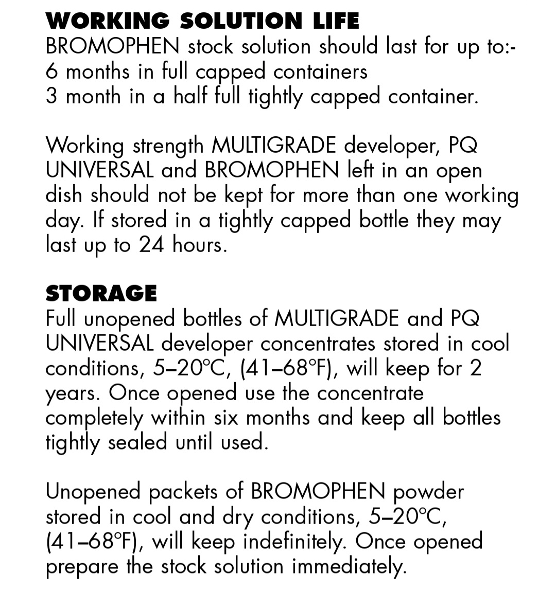

However, once mixed to a stock solution the keeping isn't as good as the liquid concentrate. Ilford says the Bromophen stock solution has a life of 6 months, the working solution life is the same for both.
Ok, I see, but the whole package of Bromophen still processes about 1.4× more RC prints than 1 L of Multigrade concentrate, and they cost roughly the same
Bromophen keeps very well once mixed (and properly stored). I use it all the time. I have been using it for a year and a half after mixing, and it was still straw colored and working fine. In my experience, Multigrade that has been opened for a year or more turns black.
The data sheet clearly states for MG
"Once opened use the concentrate
completely within six months"
So I don't understand the claim that Bromophen stock solution isn't as good as MG concentrate?

I've had good luck keeping MG concentrate in mylar bags that squash down to exclude and air and I make sure the bag is completely full. I have been able to extend the life of a concentrate that way.
I don't think I would be as successful with a mixed stock solution because of the oxygen that comes in with the water. I have not tried a longevity test though.
If you store the unused MG concentrate “properly” in appropriately-sized bottles with a squirt of butane on top, it keeps perfectly for at least a year. I buy it in the 5 litre size (better economy) and break it down as soon as opened.
