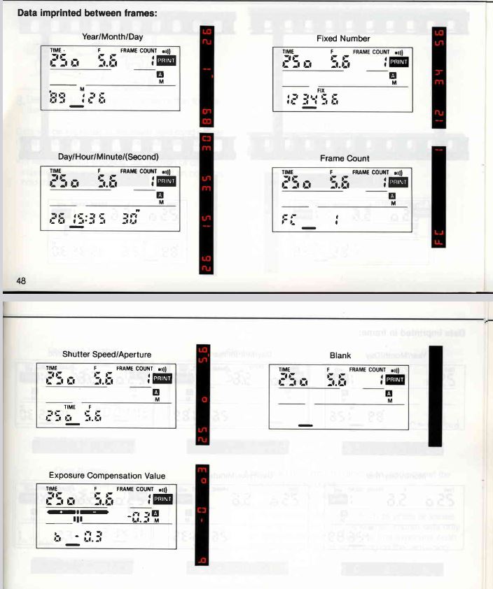

F5 also:
BradS
Sep 28, 2004
8,120
Soulsbyville, California
I think the MF-18 data back for the Nikon F3 writes between frames.

I'm relatively certain that date backs were made for every small format nikon that had an electronically controlled shutter. For sure, date backs were made for the Nikon FE, FE2, FA, FG, F3, F4, F5, F6, maybe even the EL? There was a date back for the FM2 as well but it needed a synch cord. Oh, and then there are all of the later plastic fantastic autofocus cameras too! Nikon offered date or data backs for many of them and they're all pretty inexpensive today. Nikon seems to have offered more than one model of date/data back for several of the Pro and advanced amateur cameras. The trick is to do some research to figure of which ones write info in between the frames.
I've just discovered that there are two that do so for the Nikon F4 - which is pretty cheap these days.
There's even a data back for the lowly Nikon FG ... and it goes to year 2100 !

The MF-18 for the F3 places either the date or a number, ascending (or descending as well I think) in-between the frames. The MF-18 is designed to work with the MD4 motor drive attached, but you can use the data back with or without the motor drive attached. There is a lower part on the MF-18 back which connects to the contact points on the motor drive, but you can operate the camera easily with or without the drive attached.
I've used the MF-18 data back many times without the drive attached, but with the drive attached it is better ergonomically.
Edit:
Nikon suggested that the MF-18 data back could only be used with the MD4 drive attached, their reasoning was to ensure the data imprint was truly in-between the frames.
I was about to say the same! Plus the f6 does as well. As the F3 with MF back does, it will be a good guess the F5 will and possibly the F4 as well
