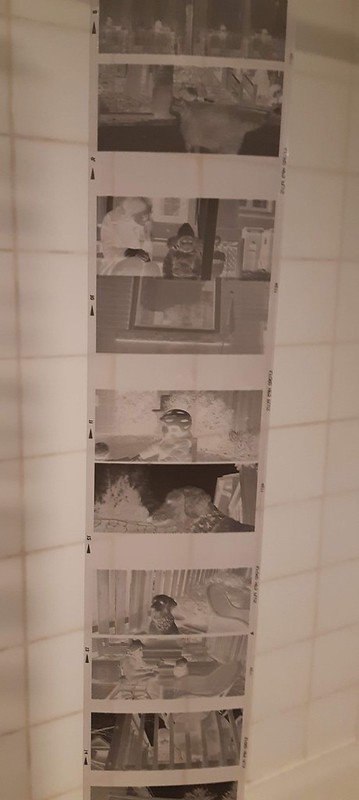

Any 6x7 camera that takes 220 can feed and advance 35 mm and (if you crop off the sprocket holes) give approximate 24x67 to 24x70 mm frame. A mask in the viewfinder will aid in framing. It's a bit wider than 2.2:1 in fact; you're closely in the range of 2.8:1. With an RB67 or Pentax, you can use a wide angle lens (I have a 50 mm for my RB67) to get a pretty wide panoramic frame.
Even a 6x6 will give you 24x56 = 2.3:1, but most 220 capable 6x6 cameras are vertical travel...
The 220 backs for RB67 are quite reasonable since 220 film went out of production (aside from home-rollers and Shanghai). If you bulk load your film, you can splice on a length of leader material to stand in for the paper header on 220, take up to a second cassette, and arrange for the film to come off the supply side spool (blue painter's tape apparently does this naturally?!), and be able to reload in the field while still getting 20 shots on a roll.

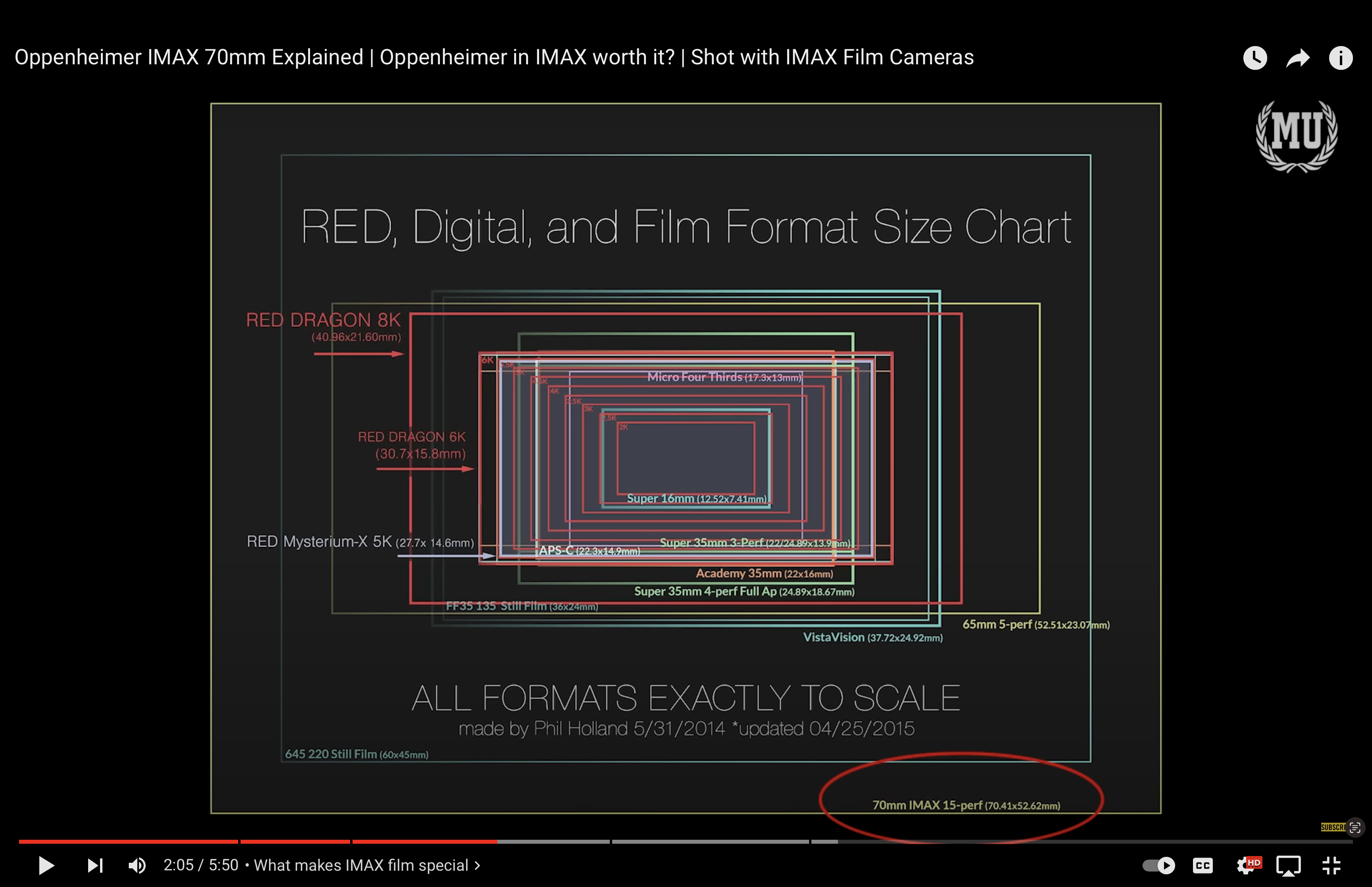

Please define the 2.2.1 aspect ratio? Ratios use the ':'
Ditto to SG's comment. There is no specific 70mm format. I have seen Imax to wide screen movies in 70mm, i.e. the motion picture print. This link shows an Imax frame: https://movies.stackexchange.com/qu...-is-70mm-print-and-why-does-anyone-care#45429
It also discusses other 70mm formats below that. The Imax example most closely resembles a 6x7 format to my eye. Many cameras to chose from. There are also 6x8 cameras such as the Fuji mentioned. There is a good deal of rounding in the 7 dimension among the manufacturers so not all the 6x7s are the same.
