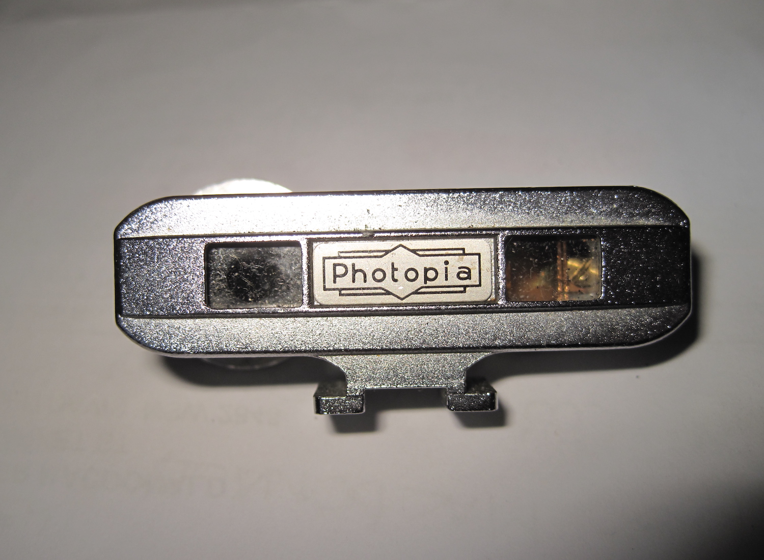

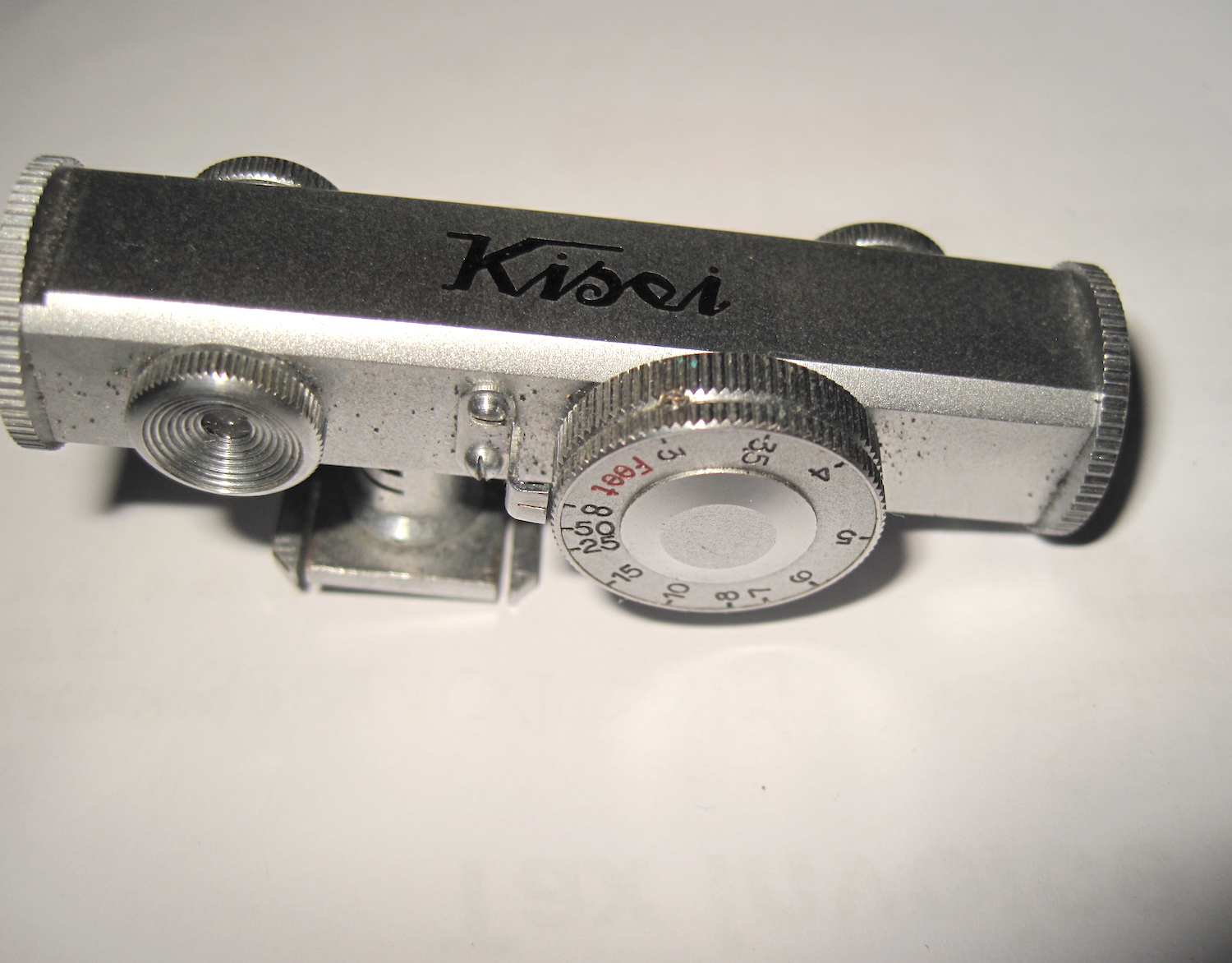

Check out Watameters. There's a company in England, Filmburbish that sells reconditioned ones. Many consider them to be the best overall. Here's a link: https://www.filmfurbish.com/rangefinders
These are the only rangefinders I use. I bought a dozen different brands and apart from these two, they all ended up in my parts/repair box for various reasons.
The Kisei is the better of the two, but they are both excellent rangefinders.
