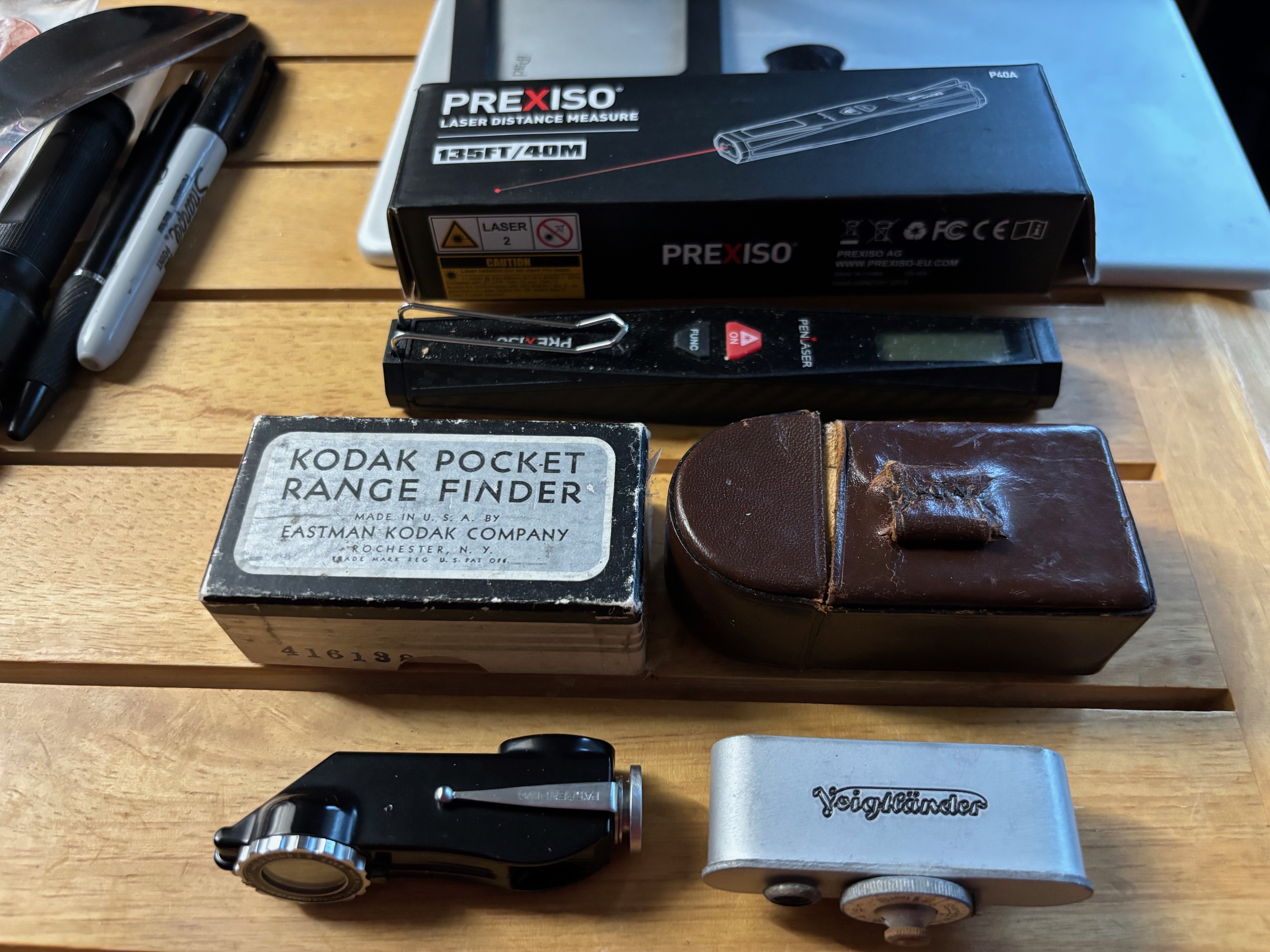

Here’s some of my quest for a small rangefinder. After several attemps on Ebay to find ones that actually worked, some sellers claimed they did-but they didn’t, I went back to using my Bosch lazer.

I've not had any luck with Kodak Service Rangefinders. I've bought several and they all have bad mirrors. The German Watameter, though, has worked out quite nicely. Every one I've bought works good and is easy to calibrate.
It's hit-or-miss with these — especially the silver colored ones that came after the black enameled ones. The silver ones are very difficult to take apart and clean, but the black enameled ones (actually called the Kodak Pocket Rangefinder — a different name) are quite simple to open up and clean.
