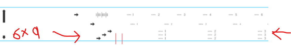

You’re seeing the multiple 6x9 tracks have returned, Matt? Maybe you should let Mr Mooney know what’s really going on with his companies products. The email interaction I posted earlier in this thread was from about a month ago. :smile:
The Thomas Mooney email you posted shows that all three 6x9 tracks have returned. As I recall it, during the height of the wrapper offset crisis, the number of 6x9 tracks was temporarily (as it turns out) fewer than that.
I'm terrible drawing/writing with a mouse, but see my red highlights here:
Yep; you are right. Sorry. I shouldn’t rely on memory. My profound apologies!
