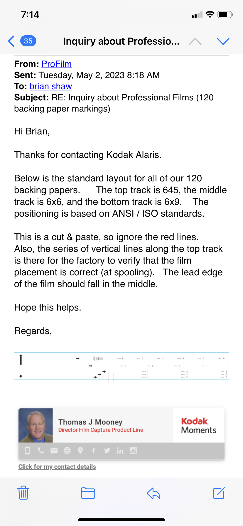

For any film from Kodak I’d assume that frame marking is provided on 120 backing paper. Because of bad info and random assumptions on the internet, I asked Kodak recently and received confirmation. They specifically stated “all” and did not identify any exceptions.

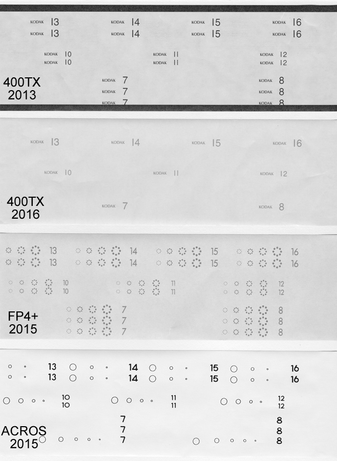

I wonder how old some of those comments are. It seemed to me circa 2016 there was a sort of intermediate step (by Kodak) attempting to reduce wrapper offset that disappeared some rows of numbers in addition to reducing the quantity of printing and density of the ink. The numbers for 6x9 frames had been a triple row but was replaced with a single, centered row which created problems. (Since 120 film goes back over a hundred years, early standards may have been loose -- or non-existent!) The reaction stirred up caused the problem to be corrected. I have a limited number of cameras to test this issue, most are 6x6, but the 6x9s I have show numbers.
I just took a quick look at the backing paper from a recent roll of 400TX and it has the triple row of numbers in the 6x9 band. The bands for 6x6 and 645 are only single rows where some earlier examples had a double row, no idea if there may be a rare camera where that causes problems.
For standard red window use, some of the changes make the little advance markers rather faint. With an old and maybe dirty red window it's easier to crank past the frame number than in the 'good old days'.
I've shot current Kodak, Ilford, Fuji, Foma, Ferrania, Kentmere, and Rollei and all have had frame numbers. As Donald pointed out Kodak printing is a light grey that is probably a little challenging to see through a dark ruby window.
The now more than 120 year old Kodak cameras that were introduced along with the then new 120 format film had/have a window that does not align with the current specification for numbering. That showed up when Kodak removed a couple of extra to specification lines of numbers in their efforts to reduce ink load on the backing paper when they were trying to deal with the wrapper offset problems they were wrestling with then.

OK, yes it looks as though the B&H comment was 2018, but during a discussion here in the midst of the wrapper offset mess, I scanned (and posted) some backing paper in 2016 to illustrate the problem (and yeah, the change for 400TX was pretty hard to ignore!):

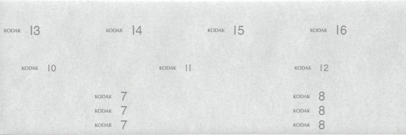

FWIW, a quick scan of 400TX backing of my most recent purchase circa 2019, Exp date Nov 2021 (yeah, I am behind!)
So Tri-x has the 6x9 numbers? Imagine my surprise a couple years ago to discover with a Voigtlander Bessa 1 that TMax 400 did not have all 3.
