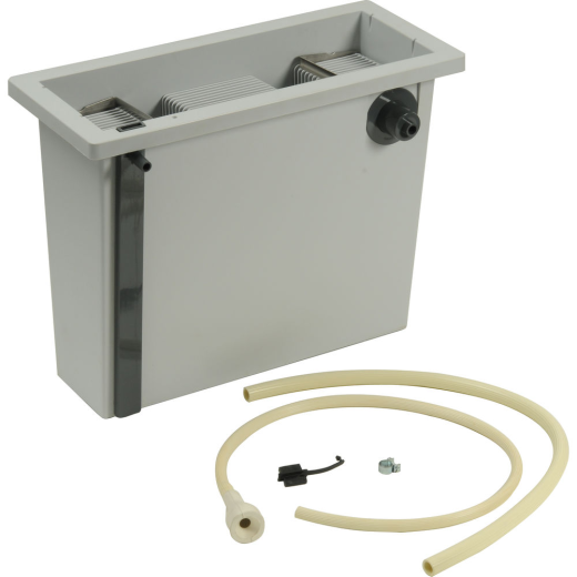

Any opinions on the (in-)famous Paterson 30x40cm print washers?
This is the washer type I've used for nearly fifty years. Its biggest sin is that it misrepresents its capacity for the common size 12"X16" paper (alias 30cmX40cm). Only 12"x 15" actually fits.
My first unit had a clear acrylic tank which lasted about 10 years before cracking. My second unit now has the opaque tank and still works well.
My Paterson Major is plumbed to a darkroom tap through a clockwork Garden Tap Timer. I set the washing time and walk away knowing it will automatically turn off and wait to be emptied when I get back to it.
The most convenient feature is its capacity for 24 8x10 prints (two rows of 12) which is about a day's work for me.
I can buy one in Australia for about AUD $400 and I think that's very good value for the convenience it delivers.
Ah what a relief to hear that I am not the only one to like that little 'thing'...
I have one too, for years, a 30 x 40cm and yes, there only fits a 40 cm wide piece of paper in it without any play!
So, at the very beginning, I trim 0,64cm off the paper which is actually 40,64cm wide due to the stubborn way Imperial measures are used even by EEC manufacturers (16"= 40,64cm).
The second caveat is that it is important to finely tune the watertap to have it rock the basket which holds the prints.
Once you know how to, that rocking works flawlessly, opposed to some criticisms mentioning the impossibility to do this, one reeds on the net...
