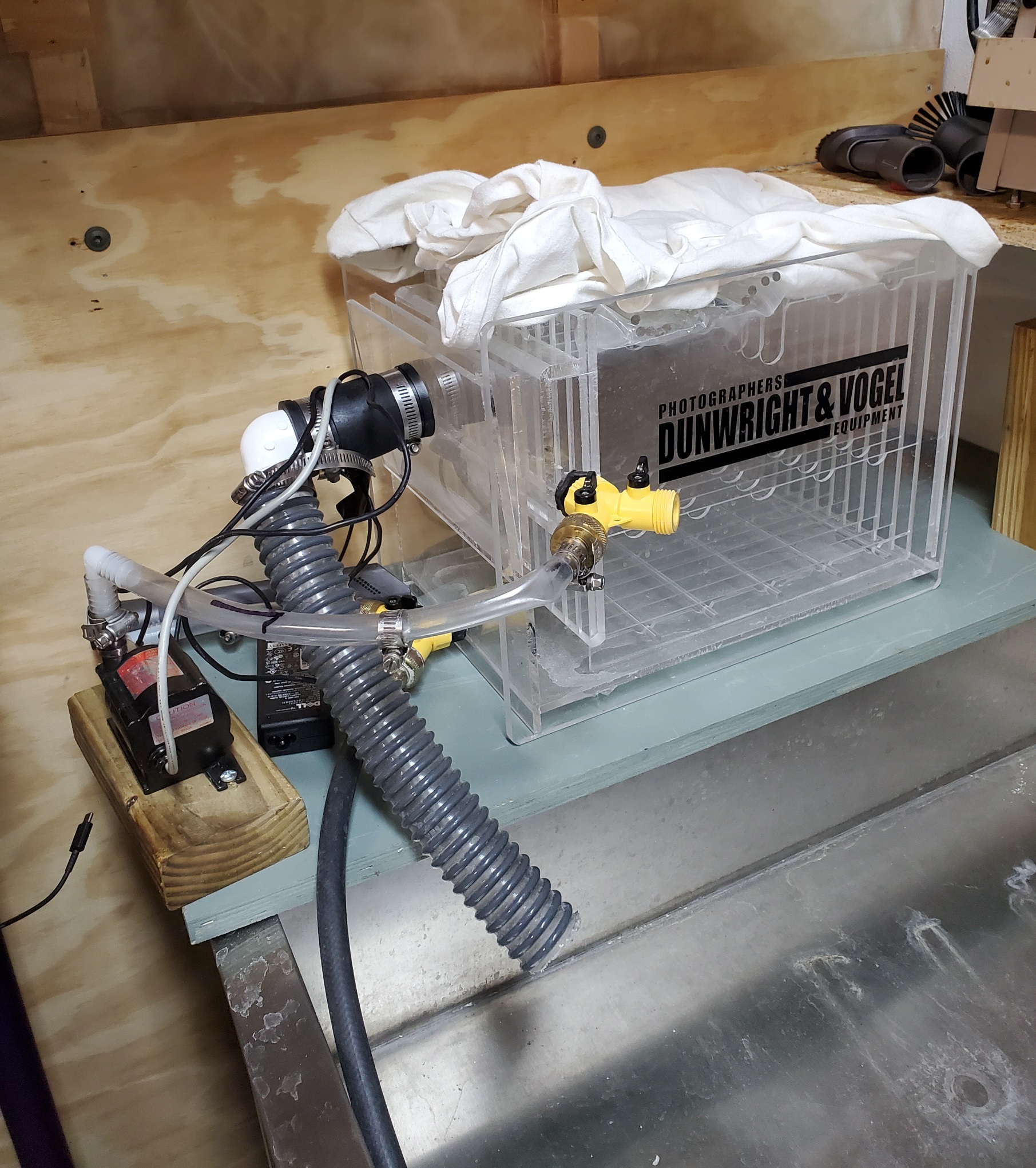

I have installed a pump on a couple of my washers. Adopted a "dishwasher" approach. I fill the washer as usual, put rinsed prints in, turn on the pump and run it for 20-30 minutes repeat a couple times. This allows for vigorous, turbulent flow across the print. I use Kodak Hypo Clearing Agent after fix, then a brief minute or two rinse, then into the washer. Easier to keep water temperature around room temperature as well.
I've picked up color processor pumps when price was good. Had to rig power supplies. Pretty much any washer can be fitted with a pump.
