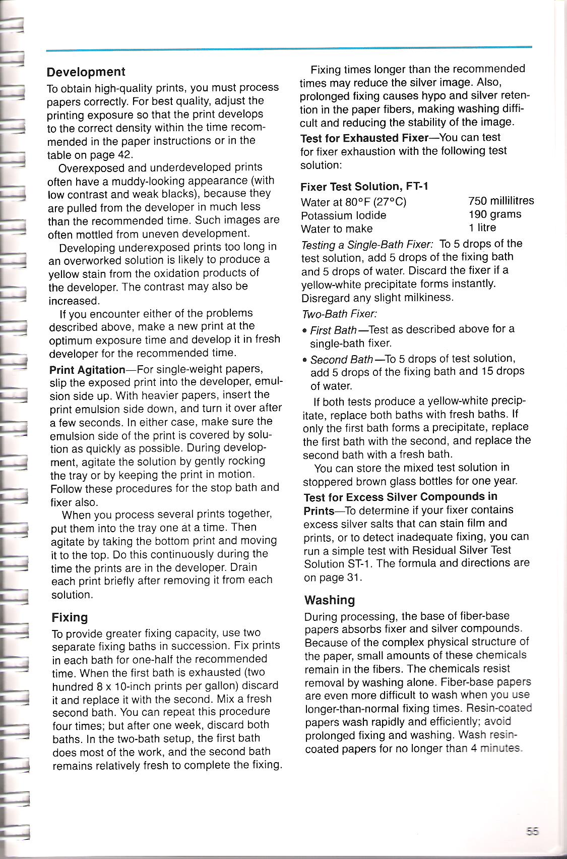

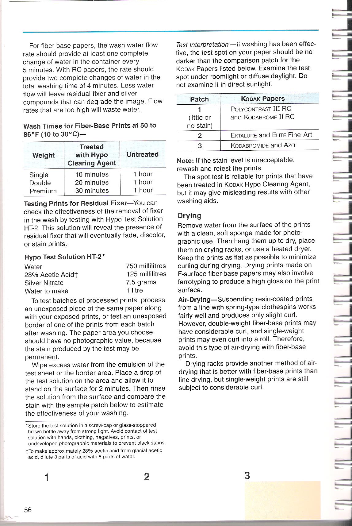

I don't see where any pumping is necessary, I sold off all my siphons years ago. I can see where you may want to use one if you are making multiple prints, probably a good idea. I use the washing guide for the HCA I purchased, or I follow the Kodak washing instructions in the manual.
