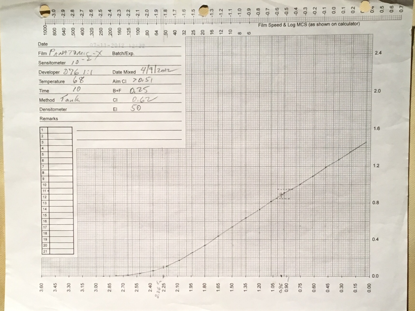

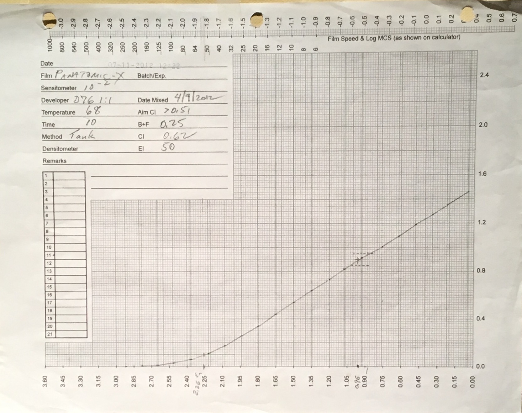

Panatomic-X has a long toe and a long straight line.
