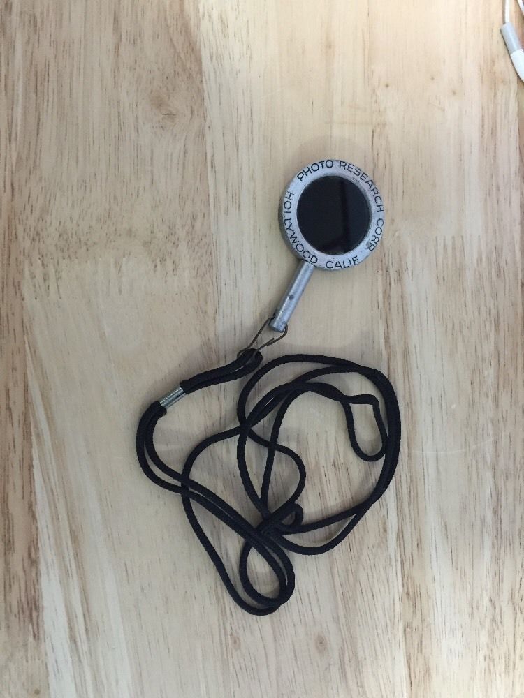

It's funny, when I bought a carful (literally) of darkroom and photo gear from an estate sale, there
was a lot of very high end equipment, and in among the gear was a "Photo Research Corp Panchromatic
viewing glass". I found it pretty interesting, although I've never used it. It's kinda cool,
says "Hollywood Calif." on it.
Looks like this one...
