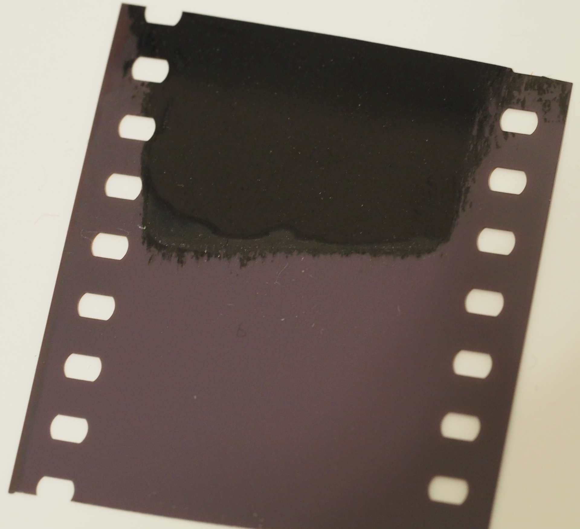

Old thread I found looking for info on processing Vision3 250D in C41. I saw a video where the guy was using a wet microfiber cloth to remove the remjet. The extra step to remove the remjet shouldn't be much of a hassle. Just curious how messy it is? How do you know you removed all of the remjet?
I'm using a microfiber cloth with the film hanging vertically from a metal film clip (Mod54, it needs a tight grip). I fold the cloth twice and wet it with the prewash solution before I turn off the lights. It should be well moist, but not dripping.
I wipe the film down and then up, twice. I think I probably turn the cloth for the second go. I also make sure not to get the emulsion side wet. That should get off the remjet. I suspect that the water left on the surface will still be dirty. That is why I wash out the cloth under a faucet. Two more cycles of wipe and wash out again and another cycle.
Then wipe down the film with a paper towel to get the base dry. This never failed me, so far. But you have to be careful not to put too much of a pull on the film, otherwise it'll be on the floor.
Remjet is left under the clips, obviously. I cut off the film ends with the clips still attached and thread the dry film onto a spiral, which then goes into the tank. Done. It's a pretty clean afair. I usually don't have any drops on the floor.
This is what the film end under the clip looks like (never mind the dust, the piece has been lying around in the open for months).

It's a mess. A black inky carbon mess that gets everywhere. You'll need to scrub down the reel with a toothbrush before you reload for the stabilizer.
I just soak it in warm baking soda solution for a few minutes after the blix. Then put it in the sink and rub it off with my wet fingers. It comes off easily. Rinse it under warm running water and then do the stabilizer.
Uh, I guess I know I removed all of it if I don't get white blotches when scanning. :smile: :smile: Seriously, I just visually inspect it.

I recommend you... use pre-bath. It's a simple recipe. Most of the remjet run out in the first wash after pre-bath.
Prebath:
Water 100F / 500ml
Borax, decah. / 20g
Sodium Sulfate, anh. / 100g
Sodium Hydroxide / 1g
Also, you can use alternative pre-bath formula, 2 tablespoons of baking soda or washing soda, but it's not so effective and you will need to wash the film a lot more.
It will save your developer as well, it's not a good way to use contaminated developer.
Also, I had a problem with some strange stain on the film, especially 250D and 500T (not on 50D or Fuji F64D). It disappears after using a pre-bath.
