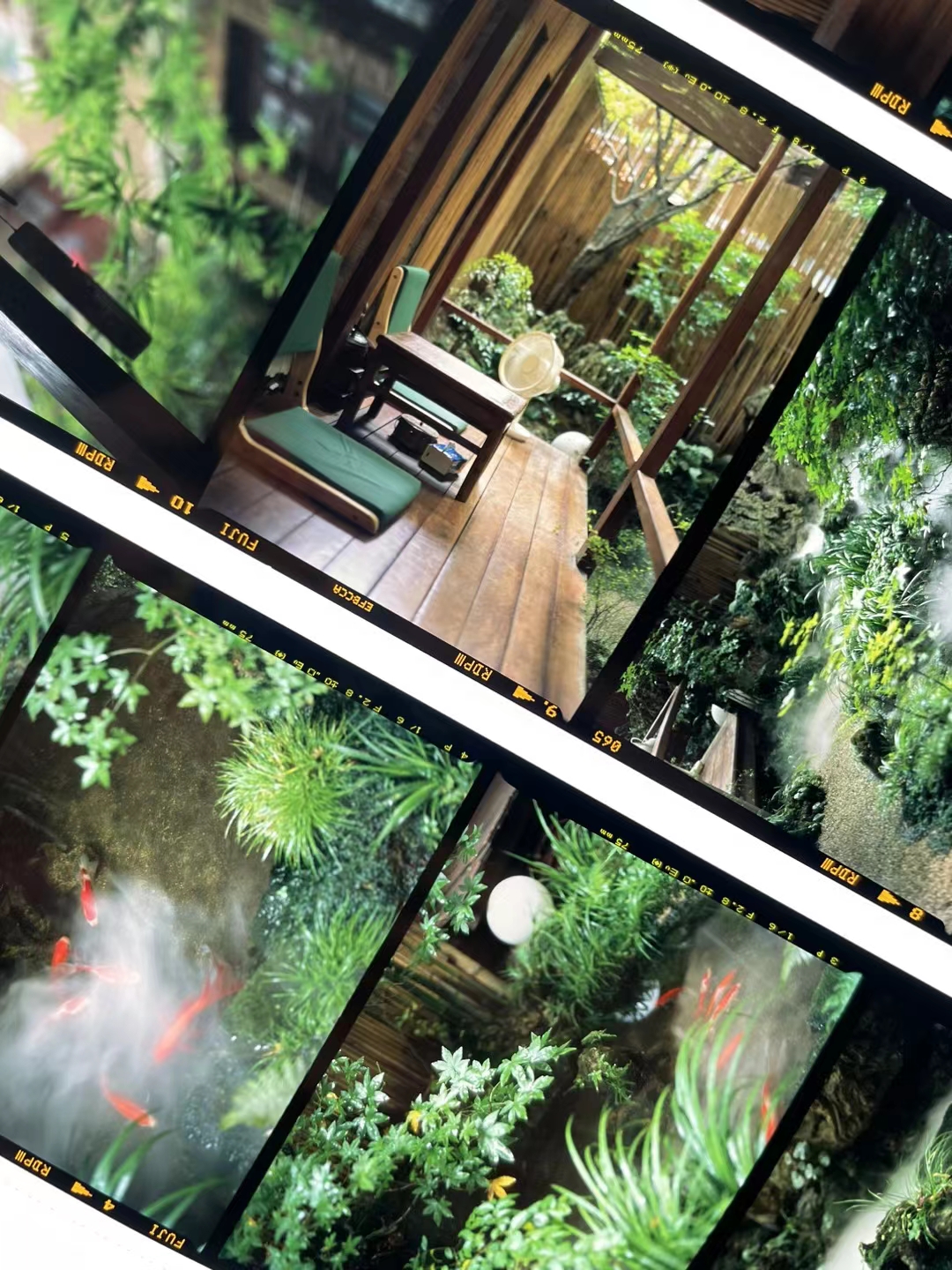

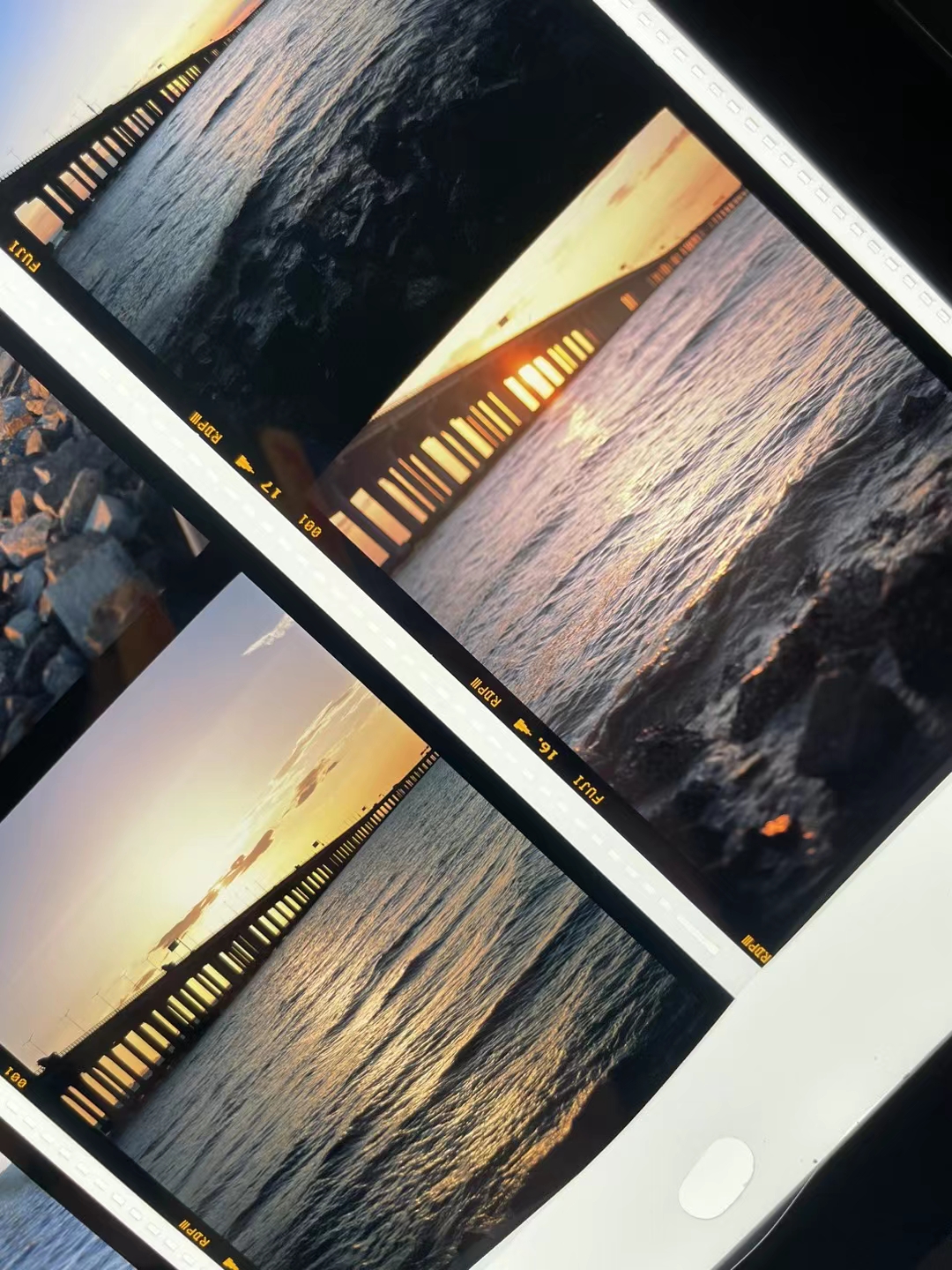

Hi all friends
I am sorry that I have not been able to understand the communication between you guys before, because I am not particularly familiar with the English names of these chemicals
I'm just now realizing that the DTOD you're talking about is (5244-34-8)
, the price I bought for this ingredient is around 100g/26usds
Because this ingredient needs very little (same as p-aminophenol)
When I told the salesperson to only buy 100g, she was probably not want to care about it😬
If you want to buy it i'll ask for her email.
And also DTPA5Na(40%),ATMP and ATMPA here is like 2-3usds/500g(But have to be aware that DTPA and ATMPA
is liquid may hard to international transport)

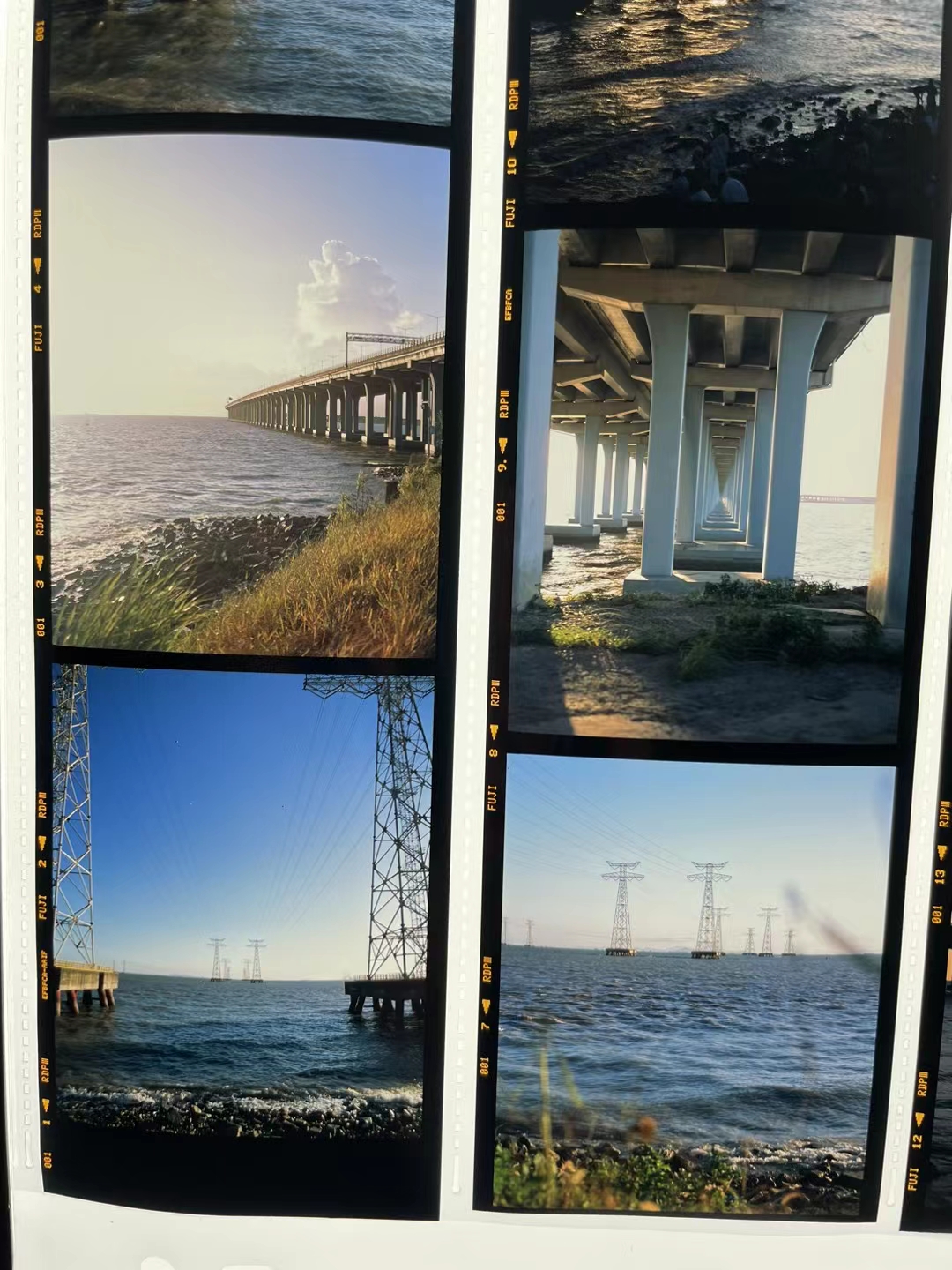

Below is some photos which were possessed by my firend using this patent E-6(Thanks to Kodak)recently
(upper two was processed by me)
I have only read some literature on the effect of the principle of E6 potion on each ingredient, may not as good as you in the research on its substitutes. It's just luck that sourcing these chemicals is easy in our country. If anything i can help you configure this Kodak masterpiece, feel free to ask me:smile:
mmexport1693307581621-jpg.347773
(processed by my friends)

Hi all friends
And also DTPA5Na(40%),ATMP and ATMPA here is like 2-3usds/500g(But have to be aware that DTPA and ATMPAView attachment 347774View attachment 347775 is liquid may hard to international transport)
View attachment 347771View attachment 347772
Well done.
