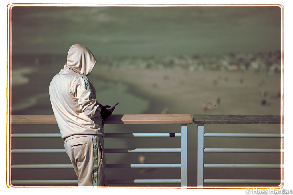

My film came in today - loaded my F6 w 80 1.8G. Figure this should be interesting shooting @1.8 only in bright beach sunshine.

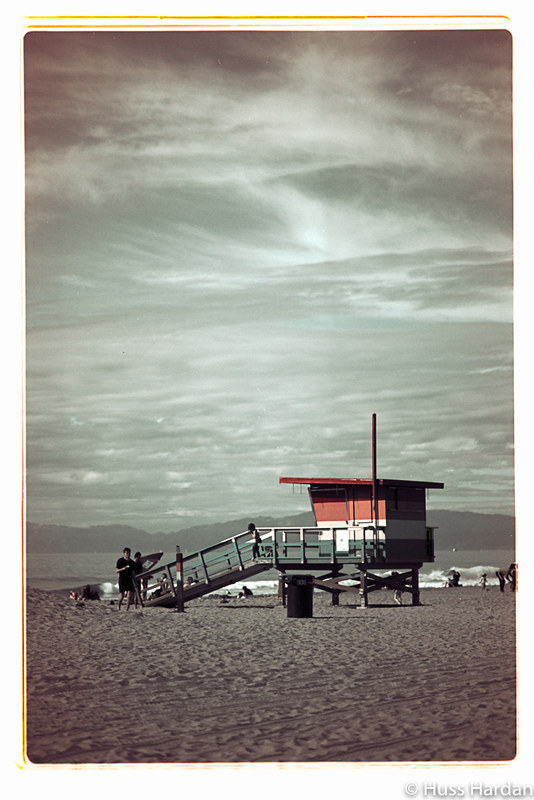

And here it is "colour corrected" i.e. how I will be using this film. Nice to have this crazy low ISO option in colour.

"Colour corrected" with greenish tinge looks really effective. Dude in tracksuit looks crazy sharp and fine grained too.
Gives those usual ultra bright california colours a nice slightly apocalyptic twist.
You need to stock up on this - it's very good work

Sort of has the look of a Two-Color Technicolor film print!
