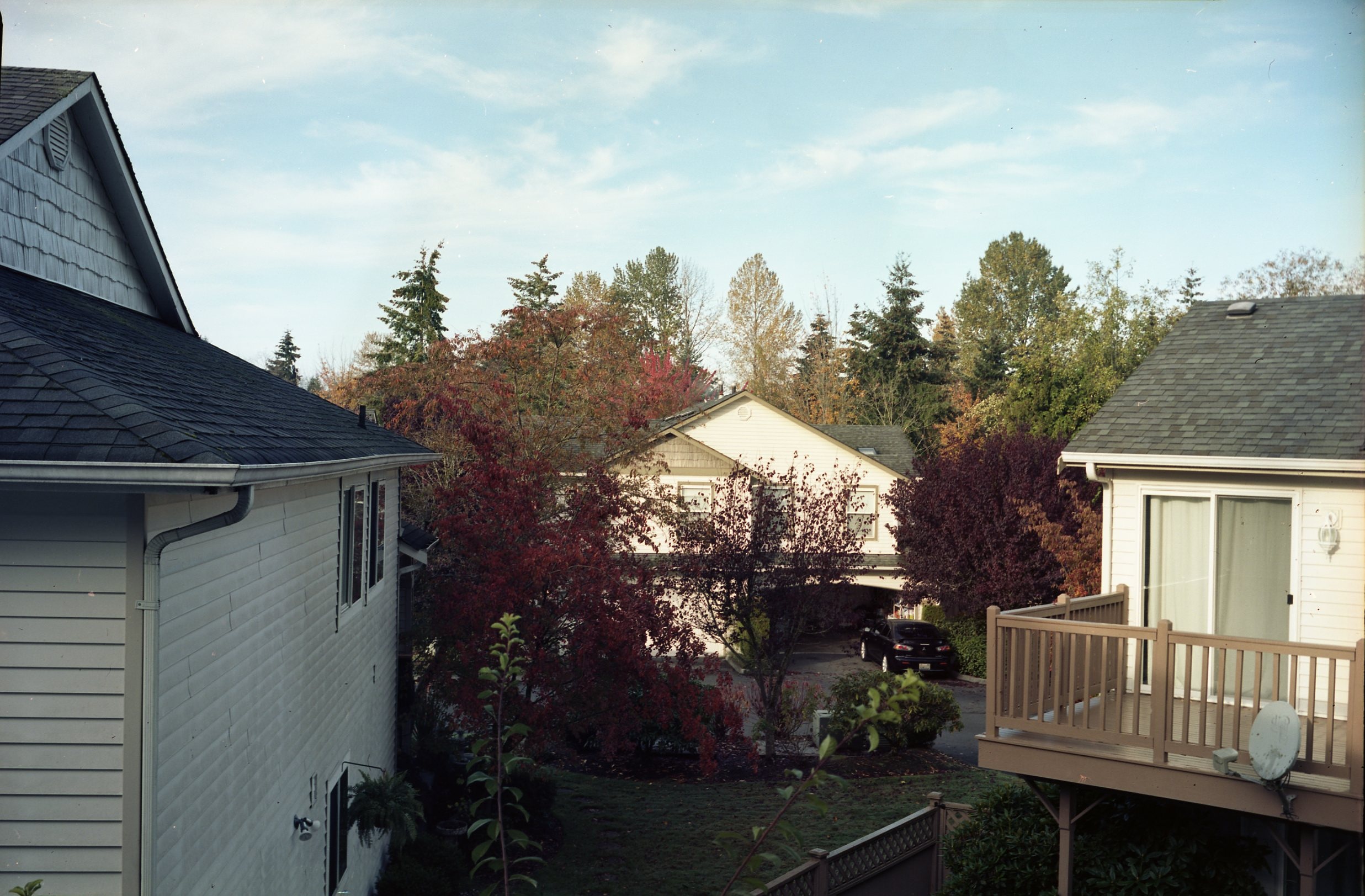

First image this camera has probably taken in decades. No editing - straight from the scanner, dust and all. This film holder seems to have a light leak on the other side, and maybe on this side as evidenced by the light areas in the sky. I used a Series VI orange filter and hood, so don't think it's flare. The orange filter lightened up the church stucco for sure. Arista EDU 400, 1/200-sec at f/11.
Theo Sulphate
Jul 3, 2014
6,481
Gig Harbor
Well done. Your work on the shutter and focus has paid off.

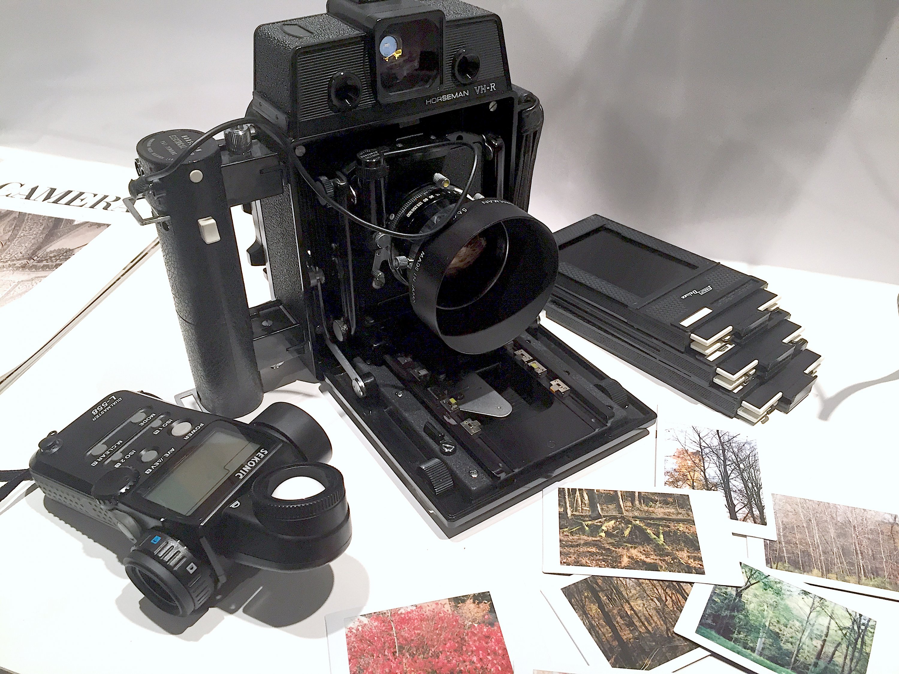

I was using my Horseman today.
Is that instant film? Are they an exact fit for the film holders, and can they be developed without an instant camera, such as with a heavy roller?
By the way, nice camera. I have the same, but without the rangefinder (VH). Use it as a portable view camera.

In did a slight modification to the flap of the film holders so it did not press down on the pod when the film is loaded. In the dark, unload them from the film holders back into the Instax cartridge. Then use the Instax camera to spit them out. I do it in my darkroom ,but it could be done in a changing tent in the field. Less cumbersome than carrying around a bucket for Type 55...

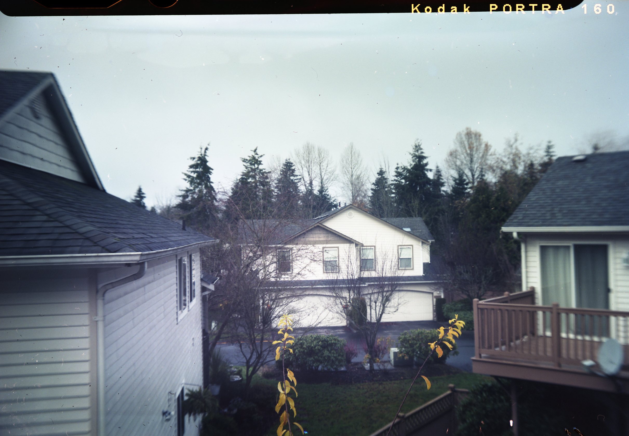

I shoot sheet film which I cut myself.
Results from this camera using Portra 160:
For the picture I used a 75mm enlarging lens and (of course) the focal plane shutter.

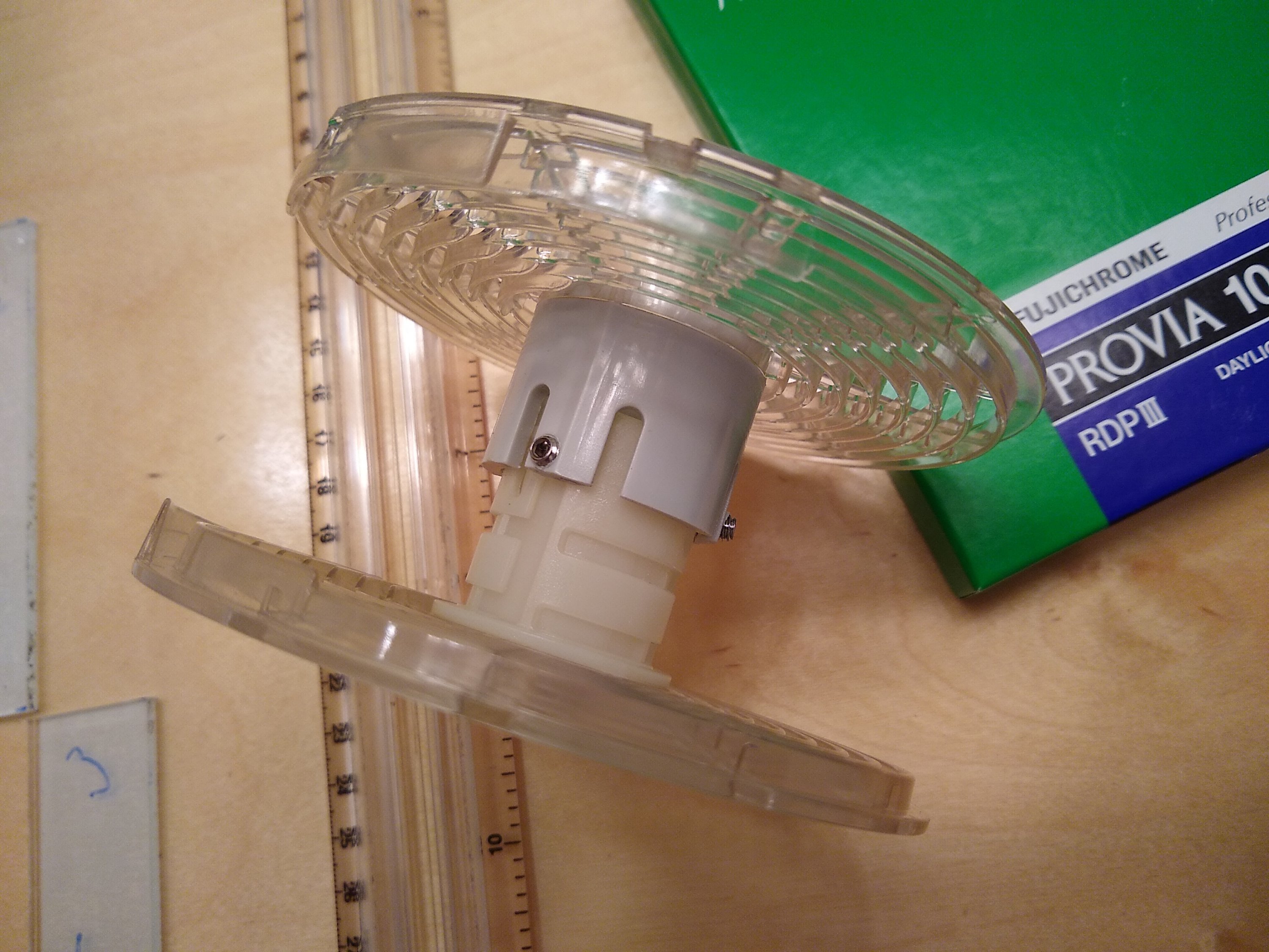

Finally my customized developing reel:
View attachment 212346[/QUOTE]
OOH You used pop rivits to modify the JOBO 120/220 reel. Now that is very clever :smile:
rwl7532
Sep 5, 2015
18
Everett, WA,
Stainless steel set screws 8-32. Later I have figured out how to keep the adjustable capability intact. Next I will customize a Paterson reel.

I think those are stainless allen head set screws— so it would be adjustable. Nifty idea!

Ralph, I don't mean to discourage experimentation and making do with what's on hand, but image quality in y'r sample shot taken with a 75 mm enlarging lens on a 2x3 Pacemaker Speed is awful.
rwl7532
Sep 5, 2015
18
Everett, WA,
Absolutely! Not on my laptop is a much better pic taken with an 85mm enlarging lens. I'll look for it.

The better picture. Fresh C41 developer. Portra 160 @ f/11 1/100 (slit B, tension 4) Graflex Miniature Speed Graphic, via cable release. No vignetting! Schneider Componon-S. Better lens makes for better photo.
Dan Fromm
Mar 23, 2005
6,943
Ralph, I still don't want to discourage experimentation and making do with what's on hand. But and however I don't think that you're getting as good image quality with y'r Componon-S -- which focal length is the one you used for y'r sample image? -- as can be obtained with a decent lens of the same focal length optimized for distance. When I was experimenting very seriously with lenses for my 2x3 Pacemaker Speed I tried out a 100/5.6 Componon-S. It didn't do as well as my humble 101/4.5 Ektar. A 105/5.6 Componon was worse than the -S; with Schneider, -S means something. All trial shots at the same distances and apertures. And there are better lenses than the 101 Ektar.
This is an old disagreement. People here and on other forums have reported that enlarging lenses are much better than good enough to use as taking lenses at all distances. Not my experience, but I haven't tried all of 'em. And casual observation finds that very few photographers use enlarging lenses as taking lenses at distance. Given how inexpensive they can be, there has to be a reason why.
Cheers,
Dan
One of the attractions of Schneider enlarging lenses is that most have cells that are direct fits in standard shutters, so are usable on, e.g., Century and Crown Graphics. I've tried out a 105/4.5 in Copal #0 Press as a macro -- 1:3 to 2:1 -- lens. Usable but I have better lenses for that application. Again, they don't seem to be in general use as taking lenses.
