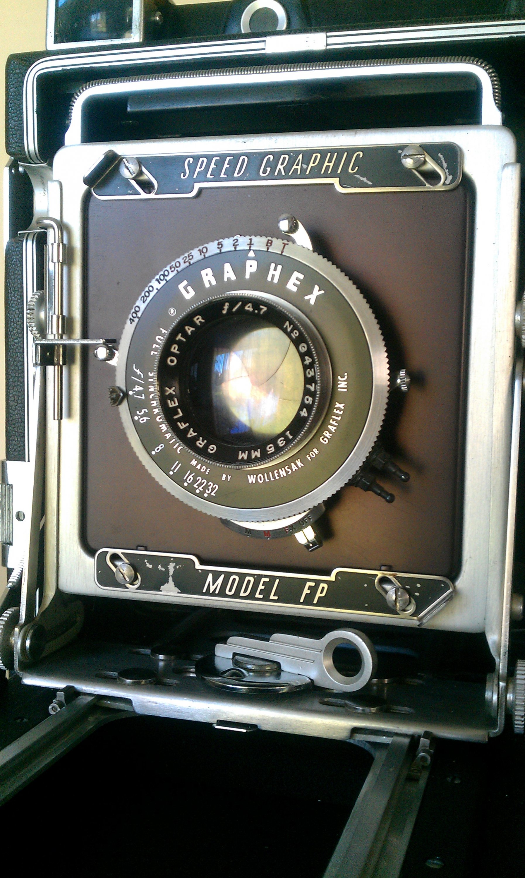

4x5 Pacemaker Speed Graphic with regular film holders and Grafmatics.
