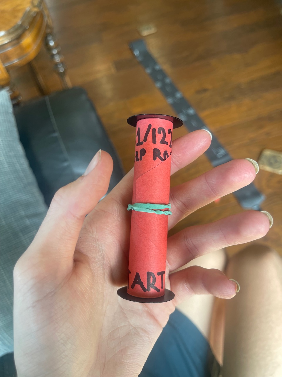

I guess I haven’t shared it here, but I’ve made some rollfilms with some paper I get from Astrum, red Soviet paper. It works well as backing paper! I did use sharpie to mark the numbers on 122 film, I don’t know how that’s going to interact with the film, so I did tell the person I made it for to use it soon after they got it. Not sure if they did or not.
