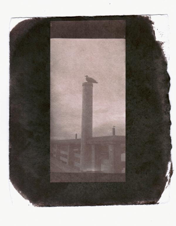

I understand about wanting to use the older cameras - this photo of mine in the gallery and its associated story (see the gallery item description) is an indication of some of where my understanding comes from.
I've had some success using adapters in the 616 camera pictured in the gallery that permit use of 120 film.
This Van Dyke print was made from a 2.25" x 4.5" negative I made on 120 film using that method:

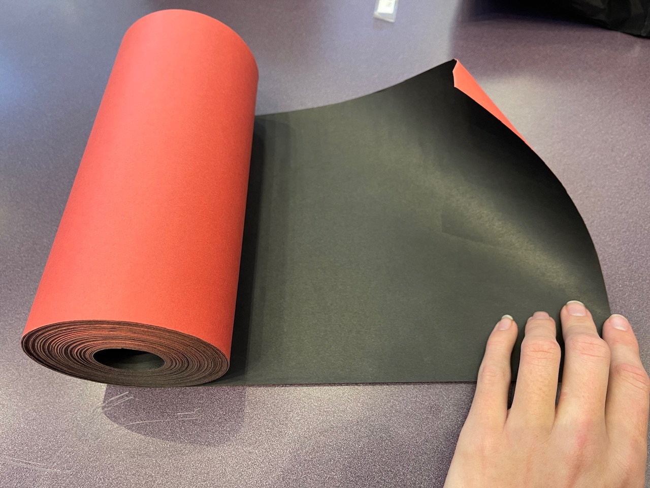

I found backing paper! It is the stuff Soviet 120 was rolled in. Comes in giant rolls that you need to somehow cut to length, and I’m sure finding an ink that doesn’t mess up the film would be pretty hard, but I have it now.
Got it from Astrum. Though I believe you need to have a $1k order from them in order to get it based on a previous conversation about it when I wasn’t ordering massive amounts of film.
Might be willing to part with some short lengths if anyone wants it. I do have projects that I want to use this for though so if you want a large amount I’ll let you know when I do my next big order from them.

Interesting. How wide is the roll?
I’ll need to get home and check, but I think it’s around 8 inches? Definitely smaller than the 9.5” film it was next to in shipping

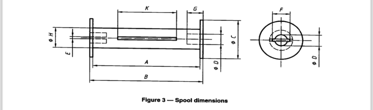

Was reading through some of the most recent replies of this thread and thought I would chime in here. Maybe it used to be thinner on the edges in the past, however now the backing paper is actually the same thickness all the way through, it’s the spools that ensure the paper fully seals against the roll. If you read the most recent ISO standard, it mentions that the flanges should have a taper, with the inner edge separation being more than the outer edge separation, so that the paper will be slightly larger in width than the spool on the outside, but as the roll is unwound the flanges will widen up and allow the roll to be advanced with less friction. I apologize if I did not do a good job explaining, but here is the relevant section in the standard:
A.4 Spool design
Two interactive features of spools are the distance between flanges (dimension A in Figure 3) and the shape of the inside surface of the flange. Both affect the ability of the camera to wind the exposed roll tightly, thereby precluding light fog. Dimension A should be larger than the width of the paper in order to facilitate tight winding. On the other hand, the outer convolution of paper should form a slight interference fit with the spool flanges in order to prevent light penetrating down the edge of the roll.
Manufacturers optimize both conditions by tapering the inside of the spool flanges so that dimension A is smaller near the outer edge of the flanges.
The tapered flanges make it practical to specify only a minimum value for dimension A. Each manufacturer has designed the spool and paper to minimize light fog and winding problems. Consequently, optimum results may not be achieved when using film from one manufacturer and a take-up spool from a different manufacturer.
And here is the figure referenced:
8 3/16”, or 810mm.
