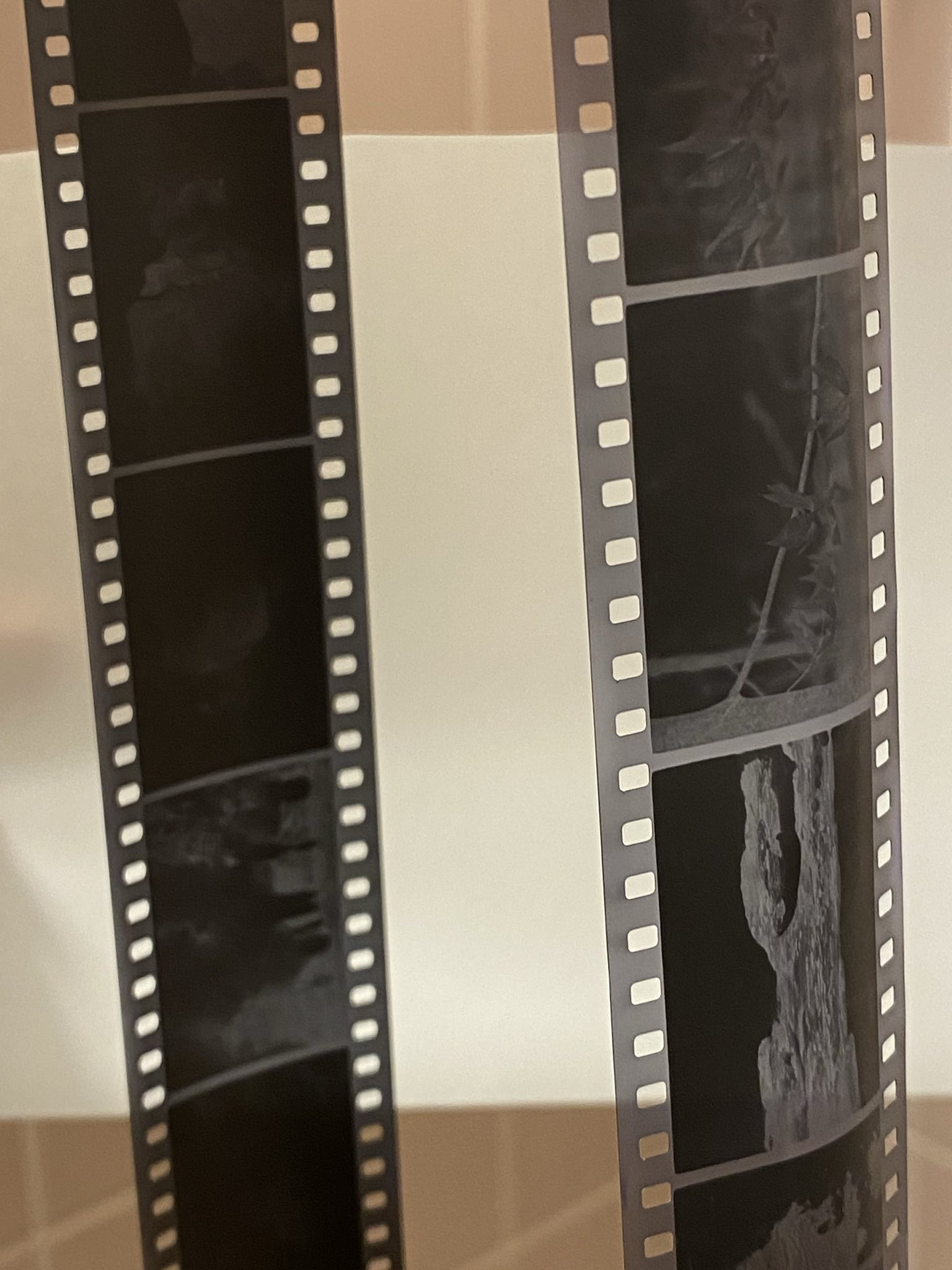

Same camera same lens same development. AristaPan 100 @ 100 on right. Wolfen UN54 on left.
The UN54 appears to be fogged and overdeveloped. The fogging is pretty even so I'm assuming it's coming from the age of the original film even though it's sold as non-expired. The AristaPan looks just right to me. Flic Film Black/White & Green 1+49 11 minutes 20C.
I am without a scanner at the moment, so I cant post the few prints I made from the 2 rolls I shot. Not bad, but not to my liking. Might be my current developers, I shot one roll at 200 and developed in Diafine, seemed low contrast, the other in Acufine at 100, better than the Diafine but not to my tastes. Tone might have improved if I used D76 or HC110. Now that Ultra 100 is back along with Kentmeyer which may be the same film I don't think I will order more.
