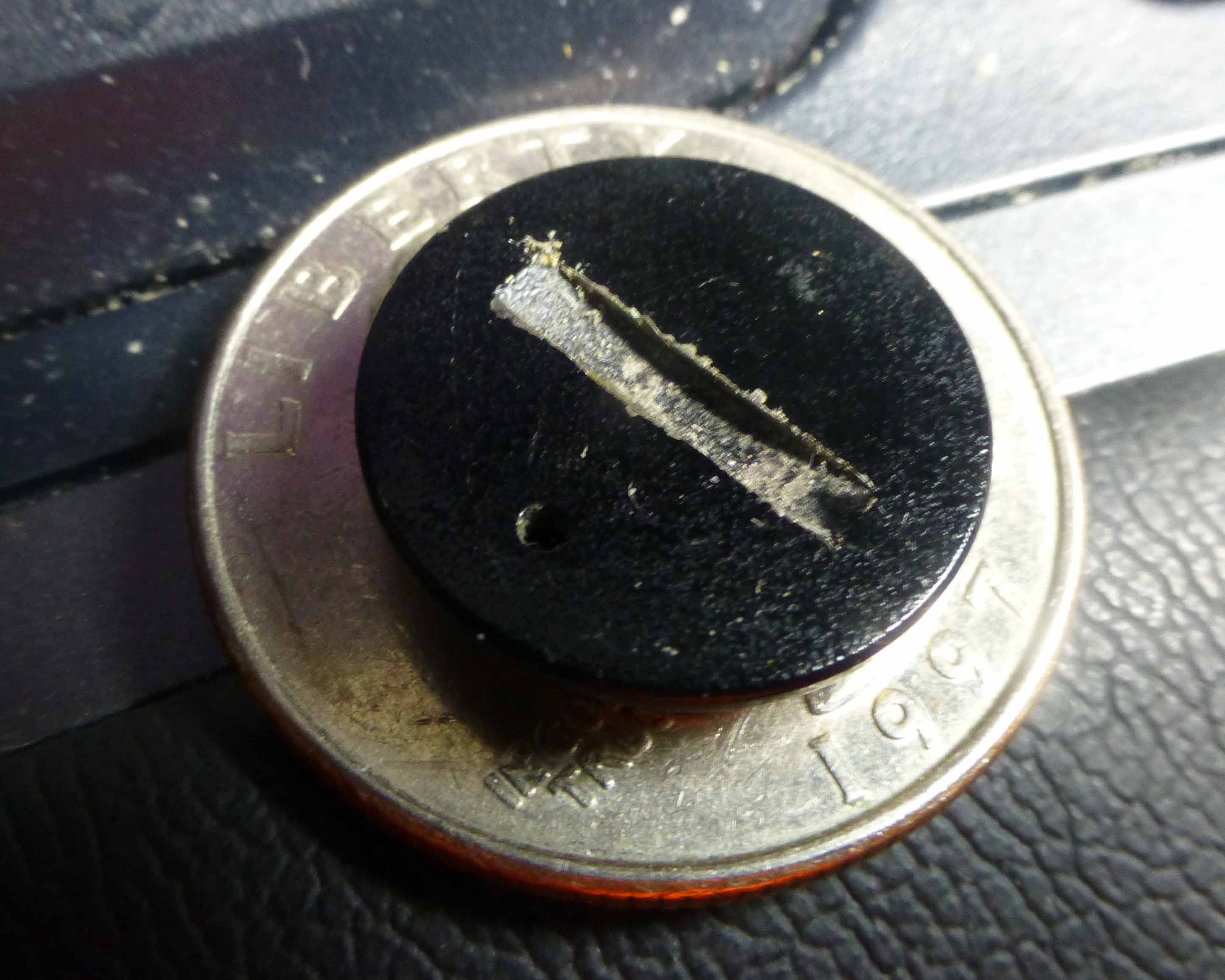

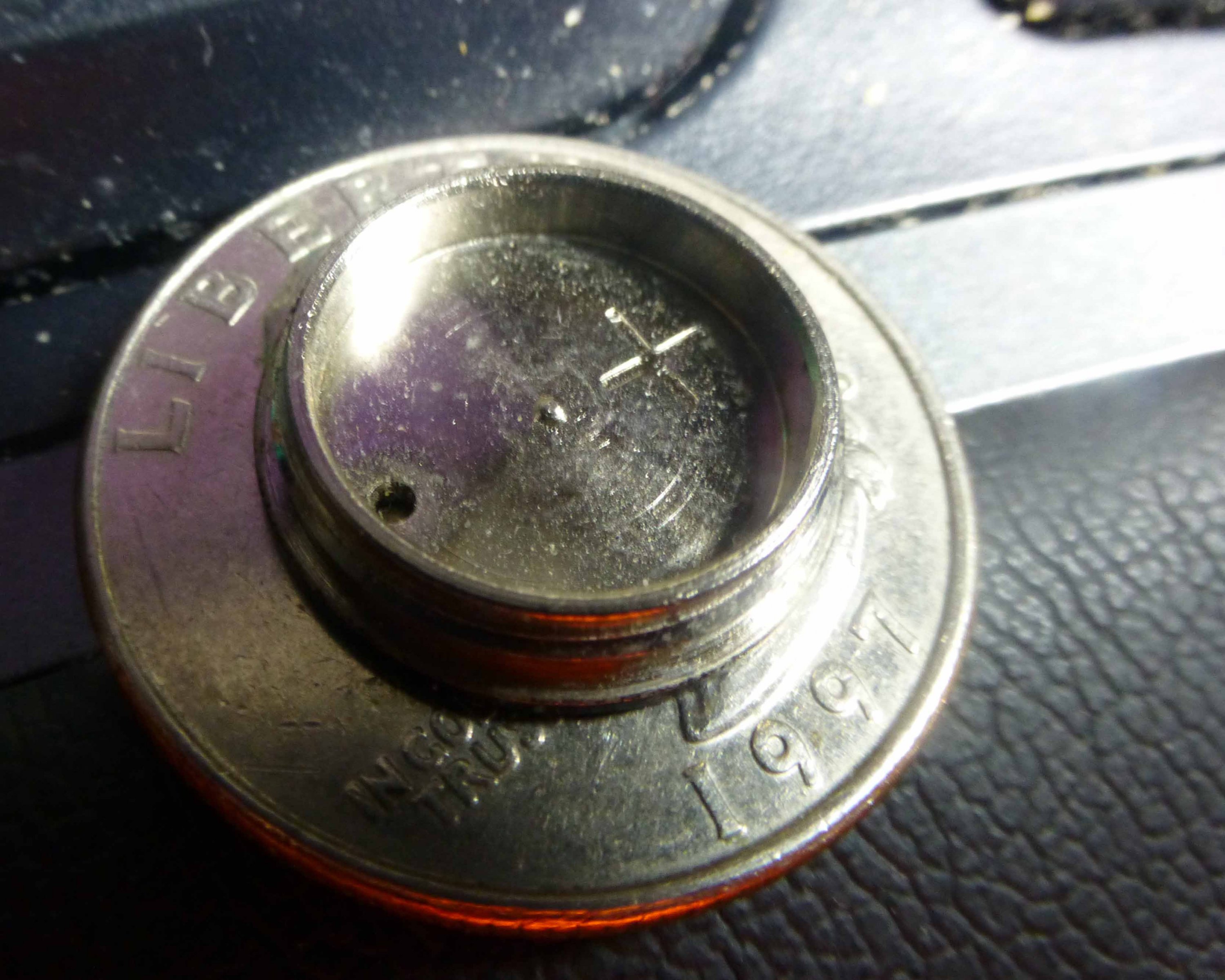

I have an extra battery cover for XA. I can ship to USA address for $8. If you are interested send a conversation to me with your email.
Sometimes that little bump in the middle of the XA's battery cover gets corroded, making for intermittent contact. If so, gently scrape across it with something sharp, and clean the edges outside the threads, too -- that's what touches to make connection to the camera.
John51
May 18, 2014
797
The eraser at the end of a pencil is good for cleaning battery contacts.
