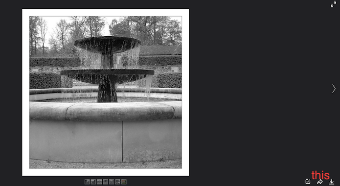

Thanks! What is the secret to get them to post in line?
On the right of your photograph on flickr there are three symbols (editing, sharing and downloading) - choose the one in the middle (sharing), copy the BBcode for medium size (800px) and and add it to your posting.
