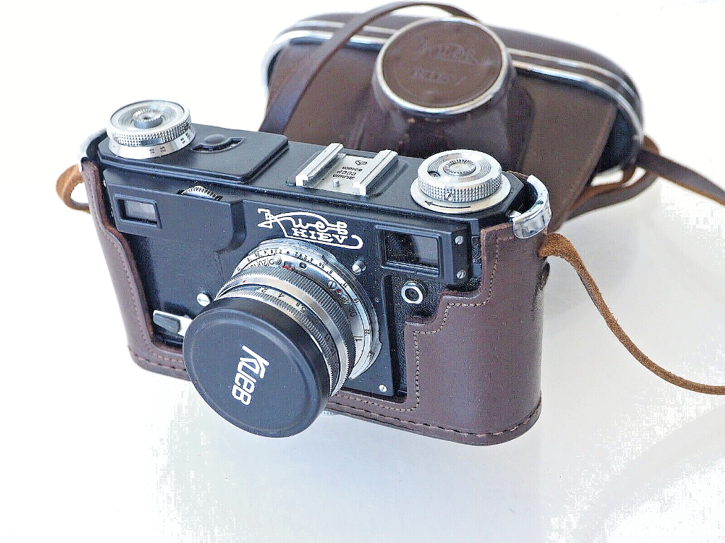

My black paint Kiev 4a was aftermarket. While the camera looked very nice from a distance, the paint was directly applied over the stock chrome finish and so was very delicate to handle. It already was flaking off by the camera back release tabs/keys.

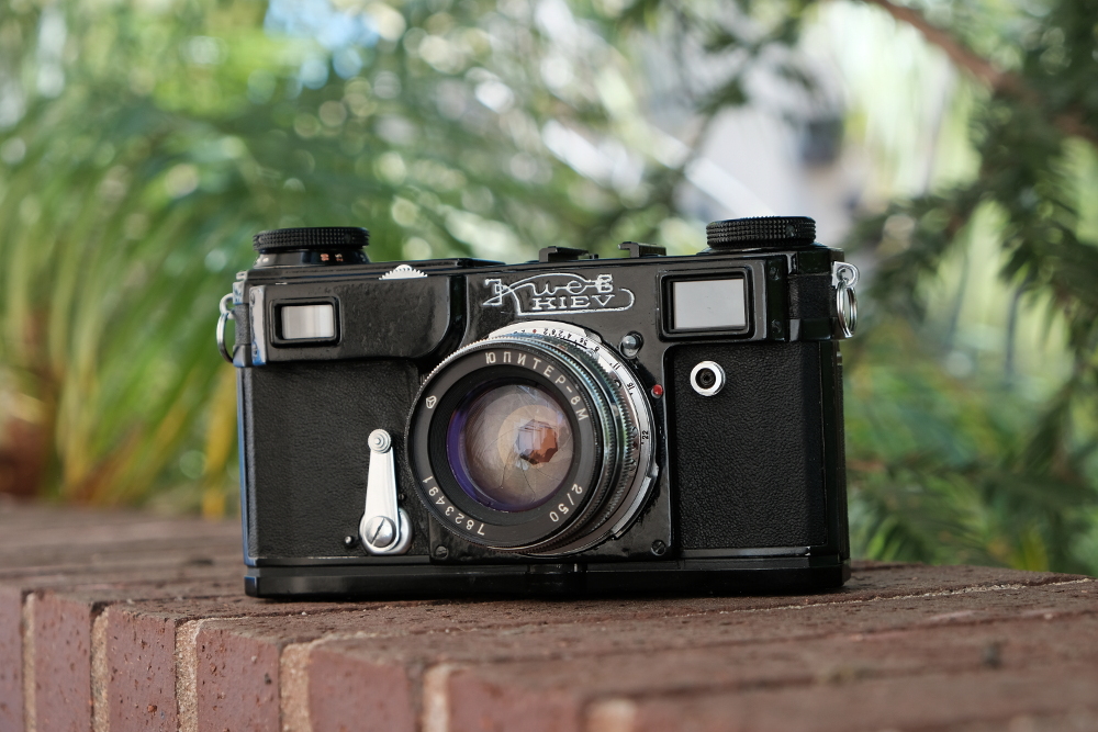

Just picked up a Kiev 4a, Type 2 (black) with Jupiter 50/2 lens. After struggling a bit (long time no film, and this is a finicky loader) I ran a test roll through. It is a bit tricky to use, but could be fun. I hope the test roll comes out ok. Seemed to wind and rewind properly.

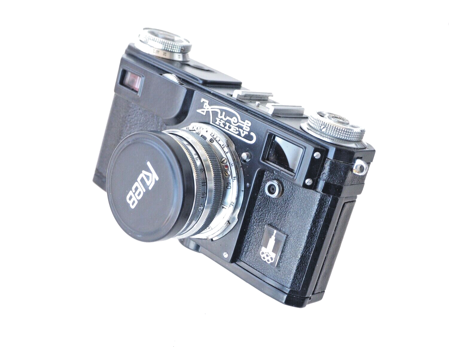

I picked one up today in sexy black and the even rarer Olympic model, built like a female Russian gold medalist.....except the focus is jammed, should be an easy fix.
Very nice! I presume this is a factory black camera? Pretty rare. What year was it manufactured?
Not sure if it is factory black (pretty unlikely) but still, Olympic versions on the Kiev 4 are rare. Look really cool.
Definitely factory, pretty sure they were made for the KGB to spy on the Yankees during the games, but as they were a no show they never got used.
The lens and camera serial numbers start with 78, is that how you tell?
Got the focus working with out even taking it apart, all seems to work good.......might even not have any light leaks.
