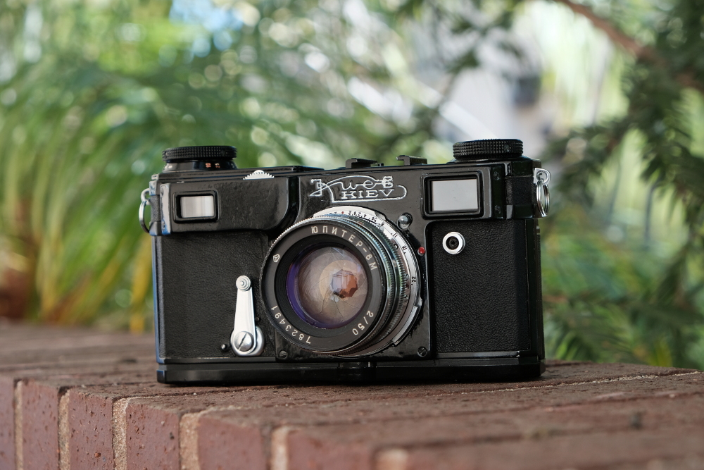

Robert Couse-Baker argues that his Kiev 4a was factory black.
For the discussion, “Was there ever a black-body Kiev 4A?” The quality of the paint on this 1969 model -- patina and all -- indicates the paint was applied at the factory. Nothing indicates otherwise.
kiev nour 1
by Robert Couse-Baker, on Flickr
kiev nour 2

The only credible factory painted Kiev would be with factory passport, indicating what it was done.
Sorry, but Robert's assumption has zero credibility. Here is no patina, but scratches on the bottom and top plates are typical for DIY soft paint. One scratch on top plate is very typical for scratch while paint is still not settled in.
It was not on demand to have black cameras instead of chrome. It was no a-la carte either. But if you know some one on factory they will paint it to any color you want for bottle of vodka.

Here is a purported factory Kiev 4M/Am era prototype from 1976. Clearly they were playing with black at that time (still open that mine is not factory). http://www3.telus.net/public/rpnchbck/zconrfKiev.htm
This one looks nothing like 1976 or original all around. It is from later versions, at least some bits are. It appears it was put together, but that does not take from its uniqueness. If it works, then all the better.

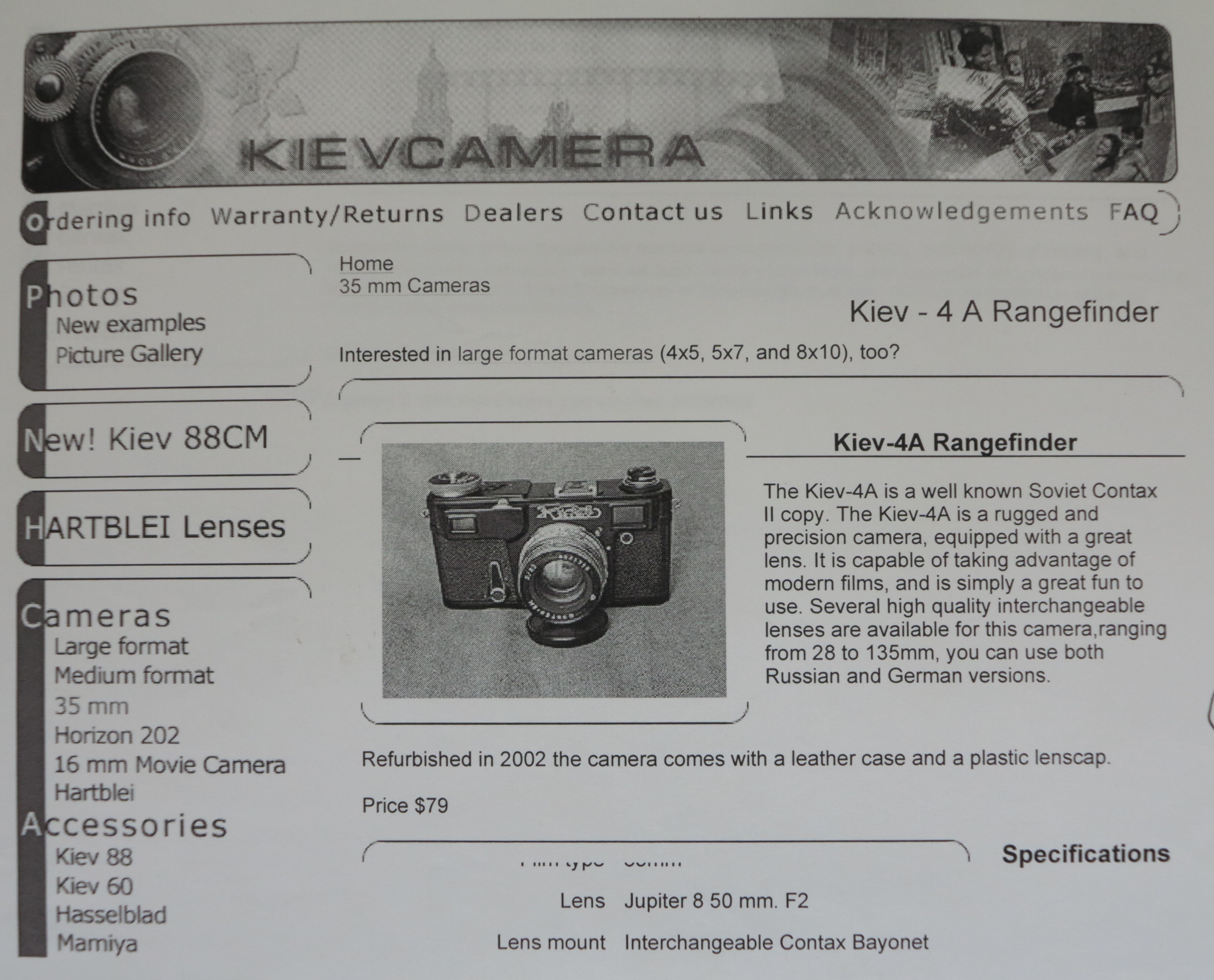

I printed the attached page from Mike Fourman's Kiev Camera website in 2002. It shows a black Kiev 4a, and states that the cameras were newly refurbished in that year.
Also, here is a copy of a Kiev Camera receipt with Mike's former business address on it.
By the way, I fully agree that there are relatively recent factory produced black cameras and also "aftermarket" examples. Thank you for the information.
