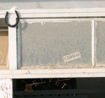

"Smart" Adobe AI 4x super-resolution from 20MP vs. "stupid" pixel-shift:
(you need to click to see full 200% crops)
