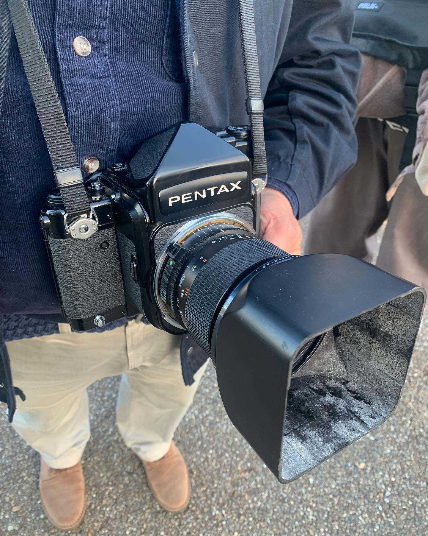

Pentax 67 modified for Hasselblad lenses, with a Planar 2/110F (2000/200 series lens with no leaf shutter). This is the lens that made this modification desirable, as Pentax lenses more than covered the rest of the range. Arguably, the 2.5/105 was just as good, I'd almost say the early radioactive 2.5/105 was better (!).
These modified Pentax 67 bodies use to be relatively cheap, but the prices have gone up (like everything else), especially for the 67ii. Modifying the P67 body was a no-brainer back then, the Zeiss lenses were worth more than the P67 bodies, and modifying the body was reversible, modifying the Zeiss lenses was not, which would make then unusable on any Hasselblad.
