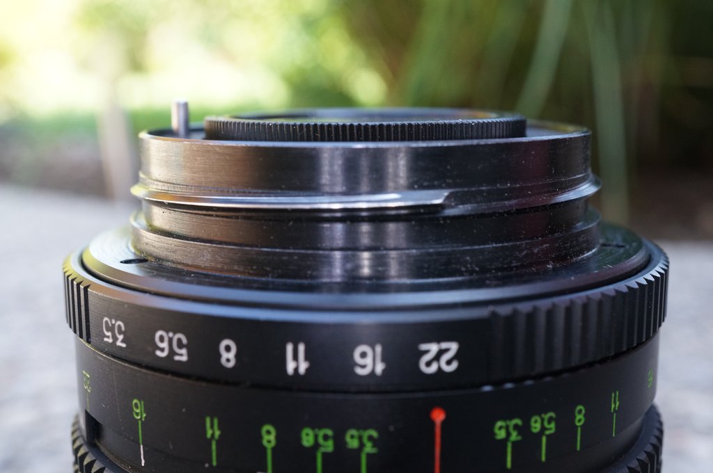

Yes, I am sure. I went back and examined it; I am certain there is no clear rear filter on the lens. I just have the Yellow, Orange and Light Blue filters that are attached to the lens case top.
I think I might have found the issue; the Yellow filter which I placed on the lens initially has some sort of malformed thread that does not allow it to fully seat. After carefully cleaning the threads of all three of the filters, the Light Blue filter fits the best and is almost flush with the end of the lens. The Yellow sits almost one full millimeter above where the blue filter sits.
I will probably remove the filter element from the yellow ring and move it to one of the other rings for now and then try to find a replacement clear filter in the 38x0.5mm size.
Many thanks to you both for the suggestions! It caused me to go back and look at the problem with a fresh set of eyes!
I will try a roll and see what transpires. The light blue (80A?) should be fine for either color or b&w until I can find another clear filter.
I have two 3.5/30 fisheyes, a Zodiak version that was modified for Hasselblad, and an Arsat version in Kiev-88 mount.
The Arsat Kiev-88 focuses to infinity on all my Kievs ('83, '96 & post '00) with the rear filter. The clearance is very tight, so the filter must be fully threaded in, and the lens properly calibrated.
The filter (knurled) extends ~1mm past the lens mount when at infinity.
the 30mm is sensitive to deviation from infinity at the stop, so tiny miss-calibrations of the body, focus screen, or lens will be visible, and one never knows what has been done to these items over the years - and unlike Hasselblad, most were never serviced.
My Hasselblad converted version only clears the 2000/200 mirror without the rear filter at infinity. It cannot clear the 500 mirror, but that is usually not an issue.
The difference without the rear filter is subtle, the center is just as good, the corners show more CA and field curvature, but most of that is gone by f/8.
If you use the len without the rear filter, the infinity stop will need to b e adjusted.

Very nice photo! My lens came with 3 color filters and no clear filter. Does your clear filter have any appearance of being a diopter or is it simply clear glass?
When not using a color filter, the clear (UV) filter must mandatorily replace it, otherwise you cannot reach focus at infinity.
