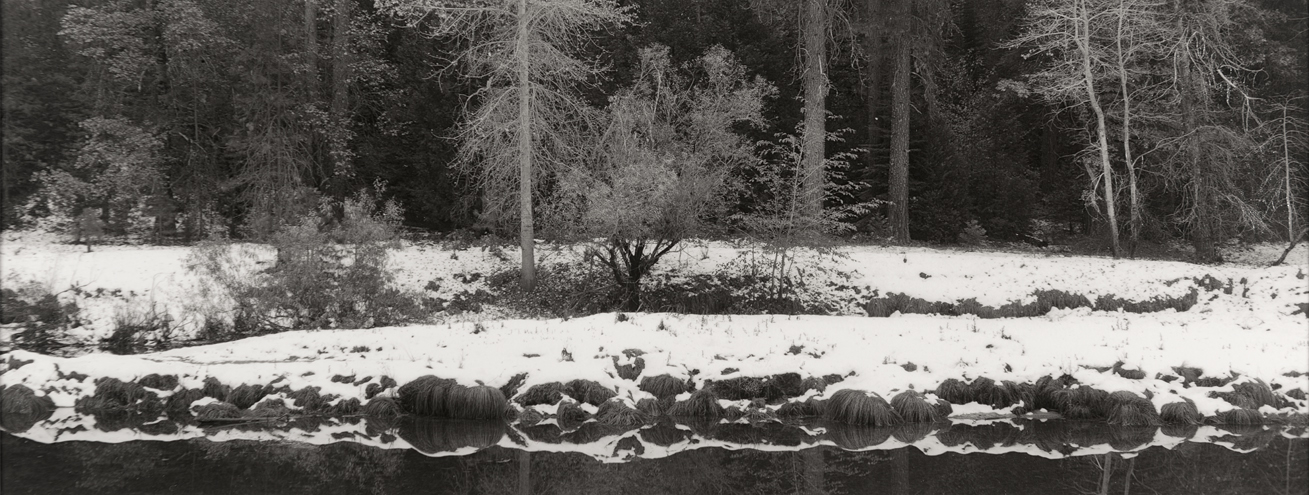

PS -- a 4"x10" negative

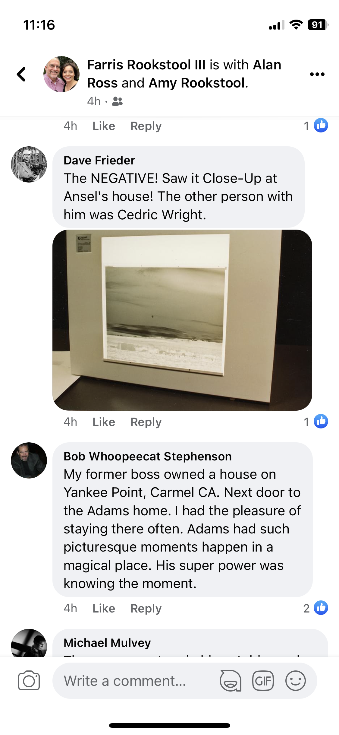

There’s a post on Facebook celebrating its birthday. Dave Frieder wrote that he saw the negative at Ansel Adams’ house.
