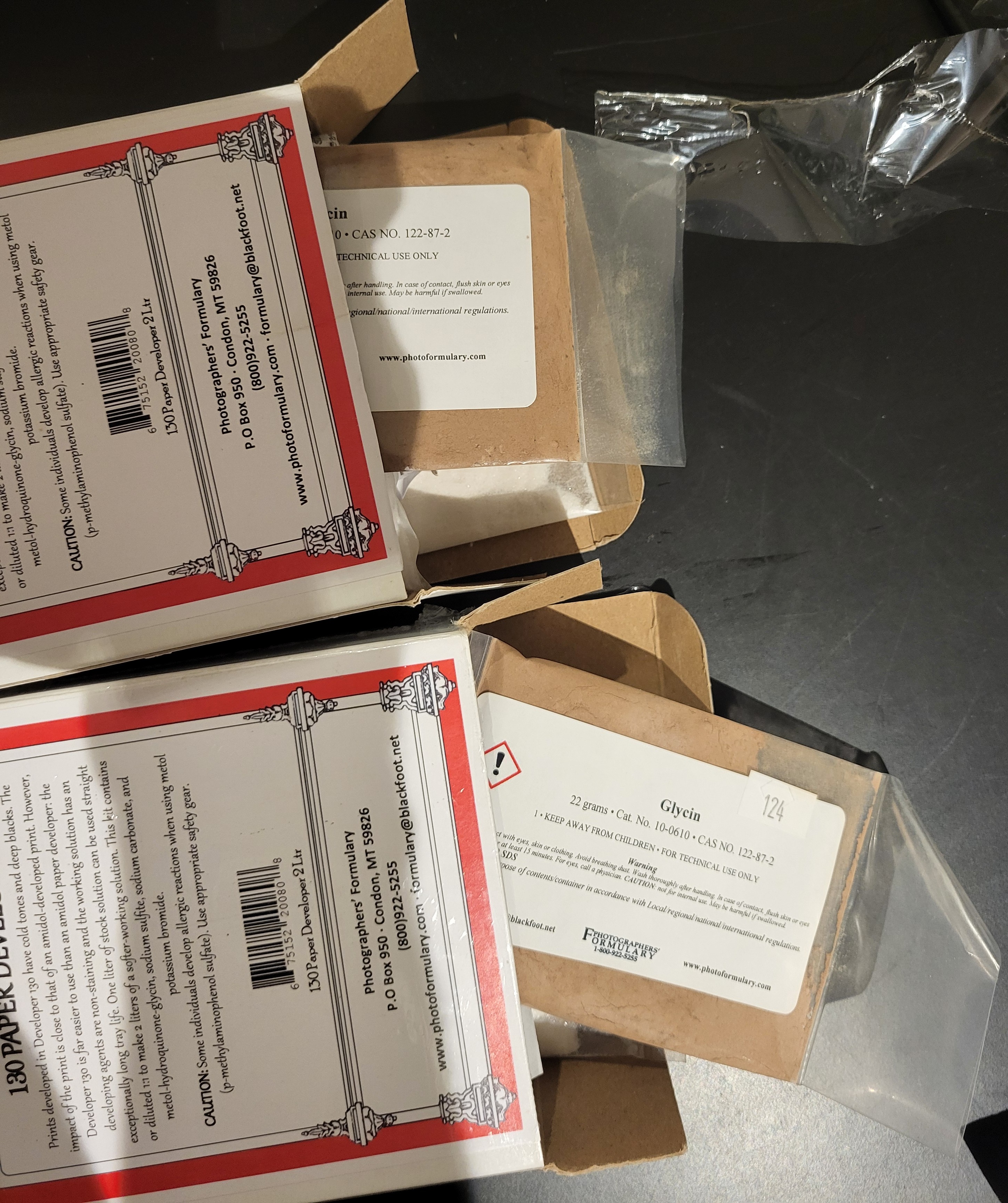

Well, just got proof that B&H doesn't check its stock of Photographers Formulary Developer 130 very often. Opened both backs, and the Glycin was this colour :
I advised B&H and they offered a refund.
So I talked to PF about this, because mine also showed up looking like that, but it worked fine.
PF told me that B&H actually goes through a fair bit of 130 so they were surprised.
I would order this directly from PF to try to minimize the risk of bad glycin. I will say that the 100g of glycin I bought from them recently was still a light tan color but not quite that dark.
I sent the photos to B&H and they told me they would talk to PF about it.
I thought about make it with the brown glycin, but since I have no way to check whether or not it's active — they really should devise a test for that — I changed my mind.
I just ordered100g of Glycin directly from Photographers' Formulary, so the other components from the B&H packs won't go to waste.
Perhaps a symptom of not rotating the inventory in their warehouse. A light chocolate color gylcin powder will work, but with a more limited lifespan. That's why I don't buy 130 kits, but the separate bulk chemicals, from PF. I keep a reserve of fresh glycin powder in the freezer; it doesn't change frozen.
Upon your recommendation, I did/do just that, but the Glycin I got from PF was light tan brown.
Light tan glycin is relatively fresh. It can be off white, but that is less common, it seems. Mocha is usable, but getting over the hill. Once it's Hershey Bar chocolate, it's questionable.
What I have seems mocha to me, if not darker, but since I'm not that good at judging colours, let me know what you think from the photo I posted.
Is there a possibility that there is no reliable direct correlation between the colour of glycin and its efficacy?
Matt in the more than 10 years that i've been using Formulary 130, that's always been the stated correlation...& why i either mixed it immediately or separated the kit and stored the glycin in the freezer.
Understood,
But perhaps that is one of those things that reflects different times, different suppliers of different constituent components and different external factors.
Understood,
Matt, there's been no update...I really can't say...but i'm betting B&H doesn't keep their stock in the freezer. I'd be interested to see a current photo from PF....if it's an issue from their end.
