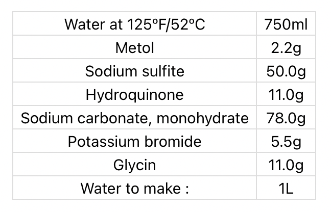

Following comments by @chuckroast and @GregY in another thread, I thought I'd be nice to start a thread solely devoted to this interesting developer.
Since I brew my own, I'll start by posting the formula:
Normal use is 1+1.

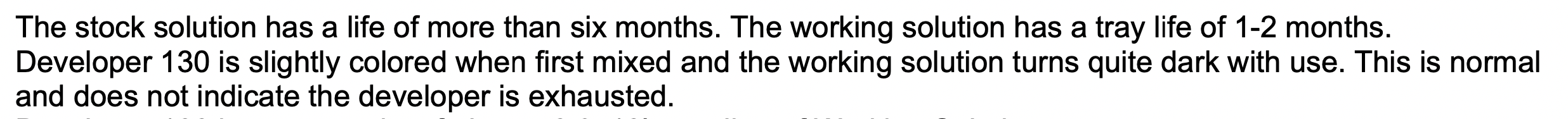

Yes, it doesn't change much once diluted. Just a little lighter at first, but it does get darker with use. The info by Photographers' Formulary is what I have experienced, whether using their kit or making my own.
