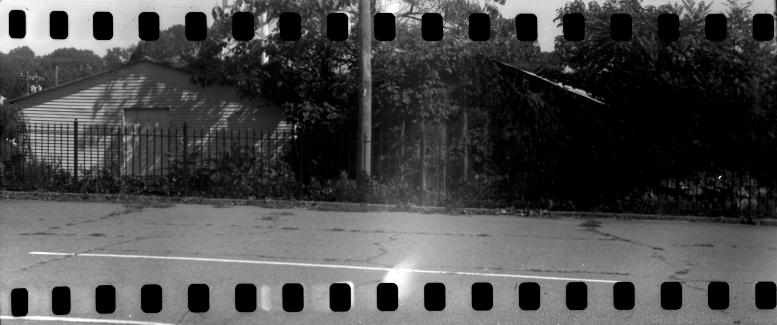

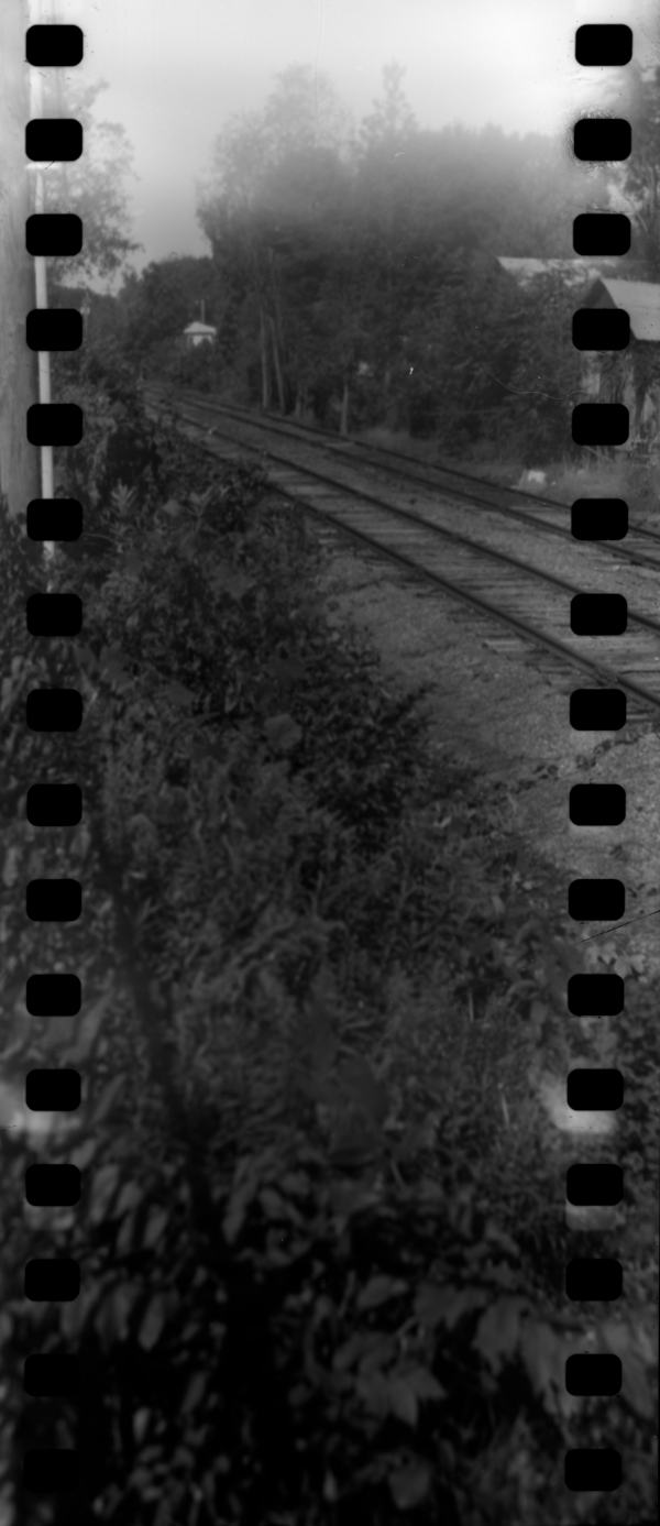

Went out to shoot some sprocket panos for Sprocktastic 2020 today. Since it was sunny, I decided to use DN21. Since I already had my RB67 220 back loaded with Superia X-tra, I picked a 6x9 folder that wasn't loaded -- my Wirgin Auta. Grabbed a set of 35mm to 120 adapters that came with my CCB pinhole camera, loaded up the Wirgin, made a guess on how many turns of the winding key I'd need for each frame, and out I went.
Came out pretty well, aside from the light leaks on the film from a bulk loader accident (I'll get past the fogged film in another couple cassettes). The adapters (one looks like a 120 spool with shoulders to manage the narrow film) keep the film nice and straight across the gate, and the Wirgin Auta has a shutter on the ruby window(s) -- leave it shut, and the back is light tight. Turns out it's 5 half-turns of the winding key at the start of the roll, then 4 after the 3rd frame; I only get 6 (and a half) frames on a 27 exposure roll.
Wirgin Auta, Radionar 105/4.5, ORWO DN21 EI 12, Xtol replenished stock (7:00).

That's pretty cool - I'd never heard of Sprocktastic day. May need to gear up for the next one.

Sprocktastic is still going -- submission deadline is October 15. Follow my link above and read the intro, look over the submissions (not sure when mine will show, just submitted last night -- this morning Aussie time).
This was my second roll in Xtol-R, I used the same time again because it seemed just about right. When not scanning over the sprocket holes (which requires a big change in black point), it scans well with that development, and applying a "similar films" factor to Lomography's HC-110 B time roughly matches the time I'm using, as does the D-96 time (with conversion factor) from the DN-21 processing instructions. Darkroom still in progress (more work on enlargers due later today). The Lomography examples show Rodinal giving a lot of contrast, but surely that's controllable with time, and with 1:50 and agitation every 3rd minute, you might pick up a little speed (perhaps EI 16?)
I'll have to see if I can cobble together a sprocket shooter. A couple weeks back I got decent results running 120 in a Kodak 1A Pocket Folder, maybe I'll do some extra long and skinny shots in that.
I did mine in a Wirgin Auta 6x9. No extra tech required (though I used a set of 35mm to 120 adapters). If your 1A doesn't have a shutter on the ruby window, don't forget to cover the window (and the autograph slot) with opaque tape. Submissions I saw ran as short as standard 35mm length (36 mm, but in a camera that exposed over the sprocket holes) up to 6x9, and then one guy used a 6x12 ONDU pinhole.
