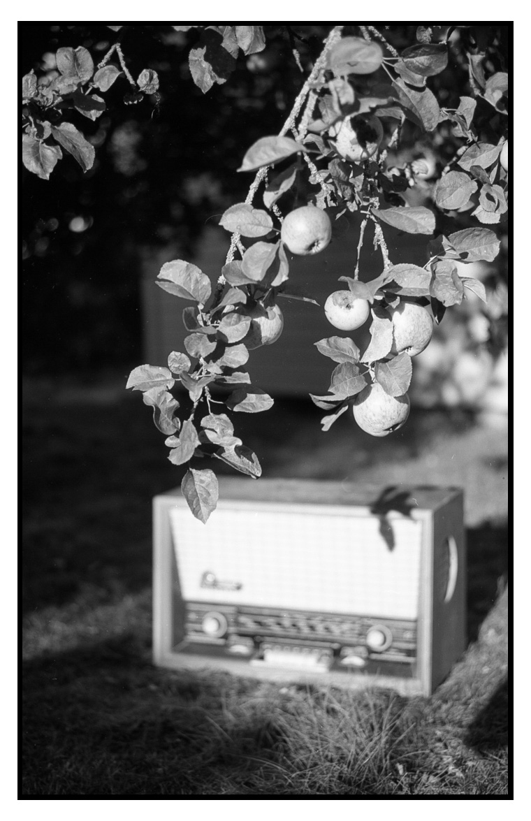

You're welcome PF. To me the most interesting thing about it is the glow that is created in back lit subjects, and from highlights. This lack of anti-halation makes it a stand out for uses where this is desirable.
Crop from one of the images above showing that glow/halation:
Love the glow, this is exactly the type of film I’ve been searching for given the demise of PolyPan F 50. Wouldn’t use it excessively, but now and again - might be good for weddings, you know the white dress in appropriate light, etc.
The lack of an anti-halation is inferred from the glow. Is this supported by the literature, anyone know?
It actually does have a anti halation layer, but it's designed for a printer lamp bulb, not camera shooting, so it doesn't work as well.

Ah, just read this: Lomography’s Babylon 13 (being ORWO DN21 based on what I’ve read in this thread) does appear to have an anti-halation layer, just not as effective as other films. Presumably because it’s a ‘copy’ film.

This is the spec sheet for ORWO DN21: http://www.filmotec.de/wp-content/uploads/2010/08/V-I-TI-DN21-e.pdf It says the film guarantees an outstanding anti-halation.
If Babylon 13 is indeed the same film, and looking Huss’s glow-full images earlier, I think I’m confused.
I think it's been well shown that this is in fact the same film (at least the same emulsion) as Babylon 13. Didn't someone read the Filmotec/ORWO edge markings on a roll of the Babylon? And Lomography gets 36 in a cassette -- but this film is thicker and stiffer base than most 35mm (to the point my Watson style bulk loader gives a workout opening and closing the gate). My second roll was 20 plus leader, and so far, so good -- loading went easily and my Ricoh Singlex II seems to have no trouble advancing. This is a metal cassette, however; a plastic one may be slightly smaller inside (since the outside has to be the same dimensions), and if so would jam with fewer frames than a metal one.

Well, I developed a short strip (12 frames) in xtol - 11 min at 20C. A few observations: first, when wet the film had some kind of "milkiness" described earlier. When it dried it looked ok, except that maybe it required a bit longer development. On the other hand - all frames were shot at box speed in "golden hour", so maybe it does loose a bit of speed in those conditions. Second - I could not scan it using my Coolscan ED V - the scanner just kept ejecting the film. Probably there is something about film thickness or maybe flatness (it dried quite flat, but my Coolscan is quite sensitive and I have issues with many brands). I will keep those strips flattened in the book under the weight and will see (it helps with other films). In the meantime I scanned it with Epson V700. And the third thing - I could not see any edge markings :smile: But maybe the strip was too short, just 12 frames, or maybe Lomography is using older emulsion from Orwo and the new one is without markings?

My Lomo Babylon 13 is marked ORWO DN21 and has that wonderful glow. It seems that just because the spec sheet mentions one thing, reality may be another!

I’ve seen your images, Huss, they speak for themselves with lovely glow-full halation. When the manufacturers say ‘outstanding anti-halation‘ it has to be be said in context, but images tend to trump words. I think the context of ORWO DN21 is that the film was conceived and chemically arranged to be a ‘copy film’, and the ahl for copying may have different demands.
Well, the anti-halation properties do appear to stand out.
Perhaps a translation error along the way?
Anti-halation requirements for a motion picture printer lamp brightness and full sunlight are quite different...
This is what I'm thinking - the anti-halation is effective in the film's intended use, but not how we are using it.

It has to be a translation error, doesn't it? People buy this film for its glow which is its outstanding "halation" property surely?. Isn't an outstanding anti-halation property one where the glow is eliminated to a degree that makes it outstanding amongst those films that themselves do not exhibit "glow"

As repeatedly hinted at in this thread copy and print films are exposed differently than camera films. This has effect on the prerequisite of halo appearing.
Yes, and makes this film quite lovely if you want back lit glow.
Since it is a copy film, the emulsion is formulated for full exposure and lots of agitation. We process it from .45 to .80 gamma; about a 4 stop range, so have fun pushing the boundaries. It can take a lot of abuse!
