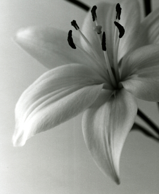

Here are scans of 2 prints. They're not the same frame, but from the same roll. Through several frames on the roll, there are those stripes. They aren't exactly the same on each frame, though, but all run top - bottom (the one is crooked because the print was crooked in the scanner). The film is Tmax 400, developed in tmax developer on a plastic reel. Did I not let it warm enough before loading?

could it be film made with 50 year old equipment in a 3rd world country?

Hold the film - emulsion (glossy) side up, at an angle - can you see surface deposit marks? If so try washing the film again - use distilled water for the final rinse or for making up your photo flow bath. I have seen this effect many times at school.
Rare that Kodak products have emulsion problems - but you never know.

The marks are parallel to the sides (no sprocket holes - 120). They really don't appear to be on the surface, but re-washing can't hurt. Originally, they were lightly wiped with wet fingers to get the excess water off, then hung to dry. I've done the exact same thing 100s of times, but never with this happening. The marks really look like they're in the film.

At first, I thought they looked like squeegy marks, but you mention wiping them with your fingers. Maybe, just this once, you did it a little too hard or had a bit of crud on your fingers. Personally, after a wash in wetting agent, I hang the film to dry without touching the emulsion in any way. Still, must be a bit of a bummer 'coz they're nice shots.

Temprature wouldn't cause a problem like this. You would see under development or over development, but I've never seen the wrong temperature on it's own cause streaking like this. The thing about these being drying marks doesn't sit well with me either. The marks are too regular, the lines too straight; and there isn't any evidence that we can see from the examples of water spots which would likely also be a problem. I'm equally indisposed to believe that is an artifact of poor quality control. We are talking about Kodak TMY. Say what you will about Kodak; their quality control is very good. In all the years that I've used their products, I cannot recall a single case when poor results have been because of shoddy materials and not my own ham-fisted and bone-headed mistakes.
So I'm really at a loss here. The most likely cause is, I believe, water marks left behind after drying. You didn't mention if you used a wetting agent. If you didn't, I'd suggest you give PhotoFlo or an equivalent product a try. I use it with my own tap water and my negatives are always clean.

Lines parallel to the sides can be pressure marks left by something on the film track in the camera. Check the edges of the frame for any kind of roughness. If that is the cause, whatever did it may no longer be there, which is very frustrating, since you won't know for sure without running another roll through the camera and in fact the whole process, but if the streak is across more than one frame, you can be fairly sure it was something somewhere in the film transport path.

I think I'll check the pressure plate idea. I have 2 backs for the hassy and this might have been the newer one that I haven't used as much. I also don't think the lines are on the whole roll, which makes it more frustrating (they're just on the ones I want to print).
