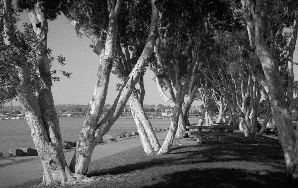

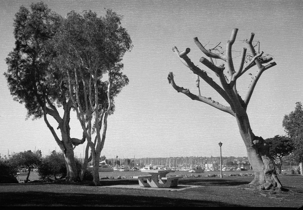

And now for some results. I chose to go with HP5, FP4 and PanF at 1/2 box speed and process in D23 1+1 intermittent agitation. Here is the first roll of PanF through the Voigtlander Bessa 1 6x9 with the Color Skopar. It turned out to have the dreaded Ilford Snow defect. These, at least, were in pretty good mid-morning sunny light.
1)

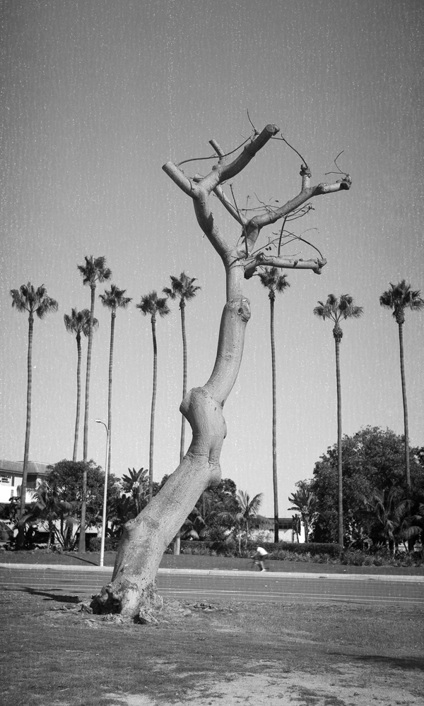

2)

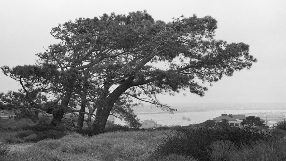

3)

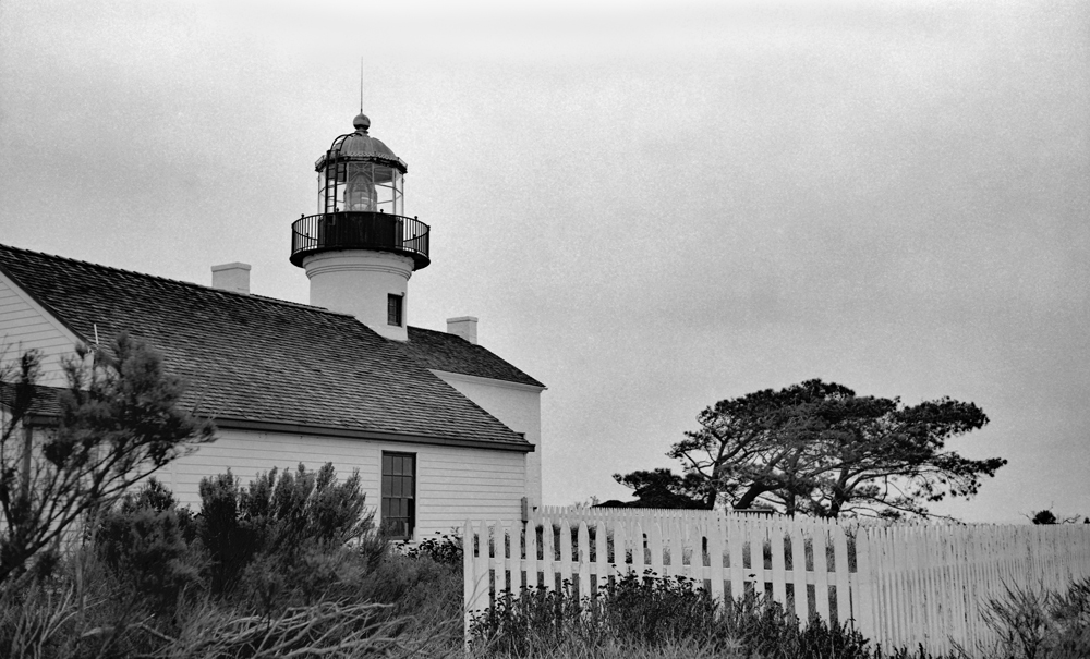

4

Was that old film? I have had the same problem with old Pan F.
It was the oldest one of the three I shot. I don’t remember exactly if it was expired or not. I’ve never shot panf in 120 before so they are all of fairly recent vintage. This roll was in the best light and looks to me to be the most well done so it is a pretty big disappointment.
More results to come with the other 2 and 15 rolls of Surfing on hp5.
removedacct1
Nov 12, 2014
1,875
97333
The only time I've ever seen negative mottling on Pan F is when its expired and/or stored at room temperature for a long time.
ags2mikon
Dec 19, 2009
716
New Mexico
@pbromaghin, your images have lovely tones. I can understand why you are disappointed. I have used a lot of Pan-F over the years and developed it in Perceptol, and it is basically D-23 with a little salt added. I have had Pan-F that was old do the snow thing too. Pan-F in perceptol or D-23 is a great combination.

I can see to a greater extent in some than in the other shots what I think you are referring to as snow but none in the first one. However other than that the PanF and D23 @ 1+1 looks like a very good combo

oh, it's there and just as bad as the others. Only a little bit of magnification will make it abundantly apparent in the sky.
I took Analogue Andy's recommendation to shoot at 1/2 instead of box speed and to use the 1+1/intermittent agitation instead of full-strength and constant on the roller. I have no PanF to compare with from before, but am interested to see how the Hp5 compares. I thought the grain looked pretty muddy in my earlier try and was close to calling it a failed experiment and going back to D76.

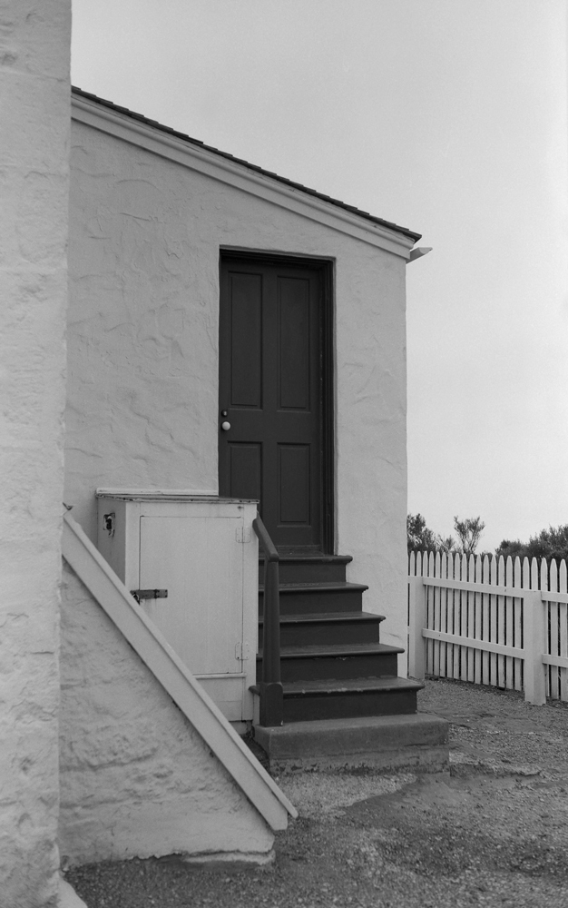

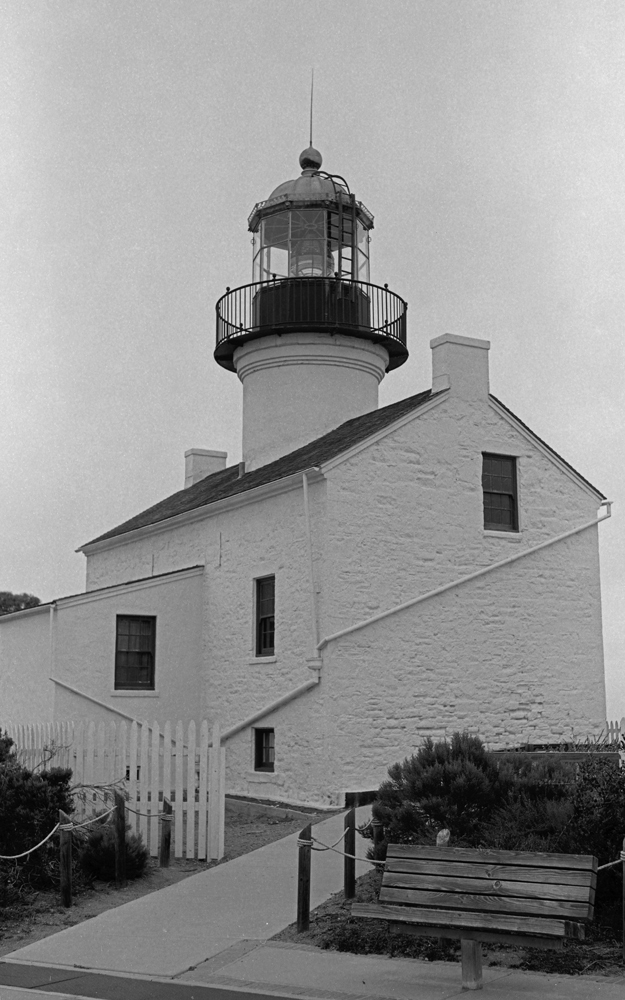

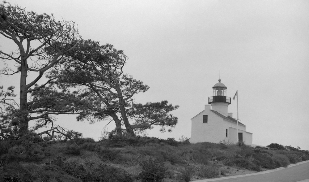

The other 2 rolls of Panf were in fine shape, but I really don't like the lighting. It was at the old Pt Loma lighthouse. Again, I shot at ISO 25 and processed in D23 1+1 with intermittent agitation.
Donald Qualls
Jan 19, 2005
12,536
North Carolina
I think that's the agitation Pan F+ likes in that developer, anyway.
