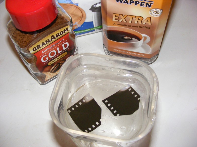

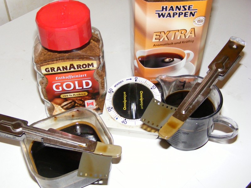

I made a side by side comparison of 100% arabica with the cheapest available coffee. No Vit-C was used, only coffee and soda. I couldn't see any difference. To make it even worse, the arabica was decaffeinated. The results were exactly the same:
Details on my blog:
http://caffenol.blogspot.de/2014/12/arabica-coffee-or-not.html
