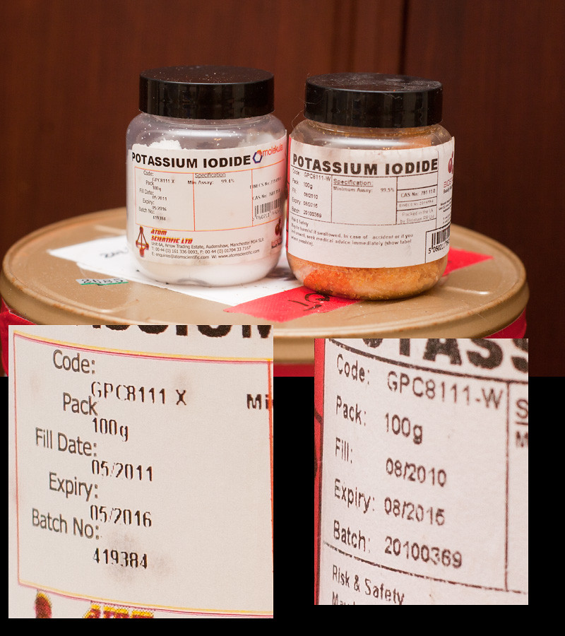

the yellowed KI is older there has been some small amount of oxidation.. moisture and atmospheric air contribute to it.
I keep my KI tightly sealed and in black, light proof bottles. This helps somewhat.
The yellow KI is probably bad. It is contaminated with oxidation products such as Periodates and also with Iodine.
PE
Still useful for preparation of elemental iodine :smile:
