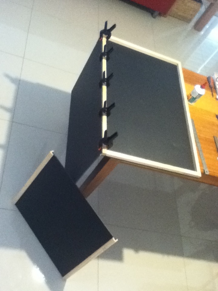

Wooden-framed foamcore box-camera is coming into shape!
That's the front (although I might make it the back) and the top/bottom getting glued on, the side on the floor is next.
Image size is 500x770mm, that's just over 19x30" (500x770mm is the size the foamcore sheets came in, I wish it had come in slightly larger sizes, then I could have fit 20x24" paper in it).
Depth of this bit is just under 500mm, it'll be the 'outer' shell.
The other piece will be possibly 250mm deep (ie, cut a sheet in half), slide in and hopefully be snug enough to not leak too much light (if not, I've got a huge darkcloth I can wrap it in).
Then I can 'focus' from about 250mm to 500mm, even out to 700mm if I'm careful not to take it apart and bleed light into it.
Or, because it's such a big area 250mm FL doesn't make much sense, so I might make the inner bit from whole sheets, and 'focus' from 500-1000mm, haven't decided yet.

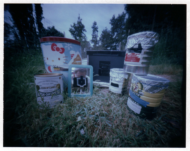

Pinhole Family Portrait
From WPPD last year, the lineup is the same this year. If I get ambitious tomorrow I might make an 11x14 box camera.
pinhole family portrait par Ned, on ipernity
Clockwise from left:
  • Oatmeal tin anamorphic with triangular pinhole made from 3 razor blades. 5x7 paper.
  • Big Hello Kitty popcorn tin uses 11x14 paper
  • In the mirror is an instant film camera with a weird looking dude aiming it. I don't know that guy.
  • Black matboard box camera uses 8x10 paper.
  • 1st ground level coffee can is for macro with a 0.15mm pinhole uses 5x7 paper
  • upper coffee can has selectable rise or fall, 5x7 paper
  • last coffee can was my first and probably still my favorite, also 5x7 paper.
As you can see, I like super-simple pinhole cameras, nothing fancy, none of them took more than half an hour to make.
All the cans are spray-painted flat black inside, and waiting for that to dry was the longest part of making them.
The cans have a 1/4" hole drilled, and then a piece of aluminum soda can with a pinhole is taped on the inside with black tape.
De-burring the drilled hole is optional, and the burrs can cause interesting effects.
I darken the area around the pinhole with a black sharpie pen on the inside.
I like to make the pinholes and then just check that they are "in the ballpark"... they are easy to swap out and I swap in new ones until I'm happy. In my favorite one, on the far right, I'm sure the pinhole is not "optimum" but I like the pictures it makes the best.
The exception is the matboard camera, where I carefully measured the pinhole with my enlarger and it is perfectly round and very thin. I made a bunch of pinholes and picked the one closest to optimum for a paper negative. That camera makes the most "sharp" images, and I like it, but it is also the least "pinholey" and more like a lensed camera photograph.
Most use tape as the shutter...with a a bit of non-sticky side folded over where it covers the pinhole.
The instant film camera has a sliding shutter made from black matboard material.
The Hello Kitty tin has a piece of refrigerator magnet for a shutter.
The coffee cans are pretty much light tight: there is a circle of black paper under the lids, but I usually put that foil on top as a failsafe.
Looking forward to Sunday. Might have a challenge because it is supposed to be windy here... so I will go with the flow and think about wind as a friend.

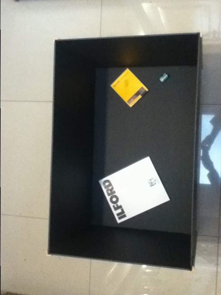

I've just realised how huge this thing really is...
attachment.php
(for scale, 135-36 RVP, 4x5" Ektar, 8x10" FP4+)

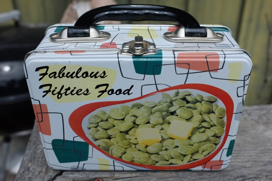

My wife was at a white elephant gift exchange and got this lunch box for me to make a camera out of:
attachment.php

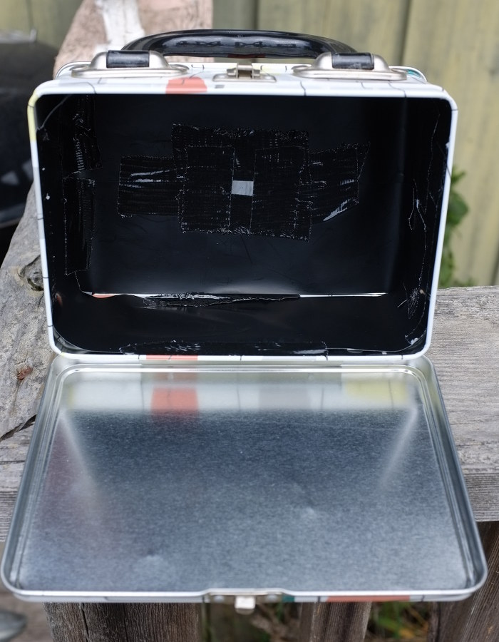

Today I poked a pinhole in the bottom, and sanded the metal until it was thin.
Photo paper will go in the lid. Then the inside was lined with 120 backing paper:
attachment.php

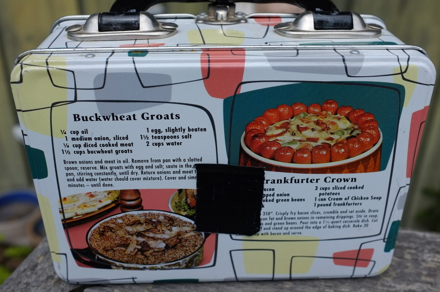

It uses a piece of tape for a shutter:
attachment.php

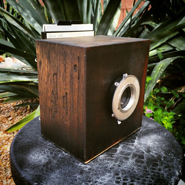

For WWPPD 2016 my camera is a converted cigar box 4x5. Focal length is approximately 120mm and the laser drilled pinhole is .5mm (f/240)
