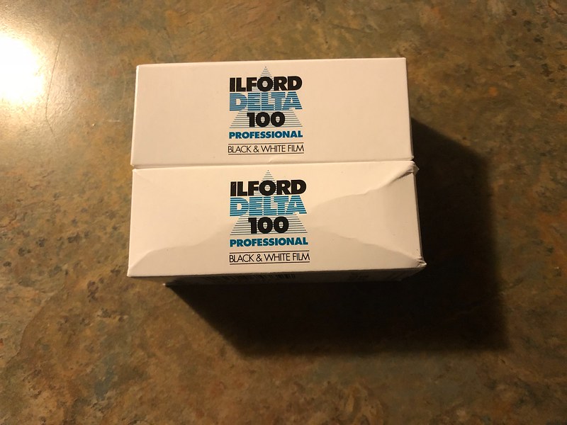

I've given up hope of every finding Acros for sale in the US so I bought these two rolls for $18. That hurts when 5 rolls of Acros cost me $24. I'm looking for ideas on how to develop this film in HC-110, dilution E. Acros did very well at 7 minutes at 20 C. Would this film be much different?
There's nothing about dilution E there.
For the most part, HC110 responds linearly to dilution changes. Doubling the dilution means doubling the development time and so on. This should give you reasonably good results, but some fine tuning may be needed.
This page states everything you need: dev time for Ilford Delta 100 in HC-110 dilution B, and conversion formula for dev times from dilution B to E.
Try it with 7:30min / 20C (@ ISO100) - good results even with Tetenal Ultrafin (not plus) 1+20 / 20C /10min. Good luck !
