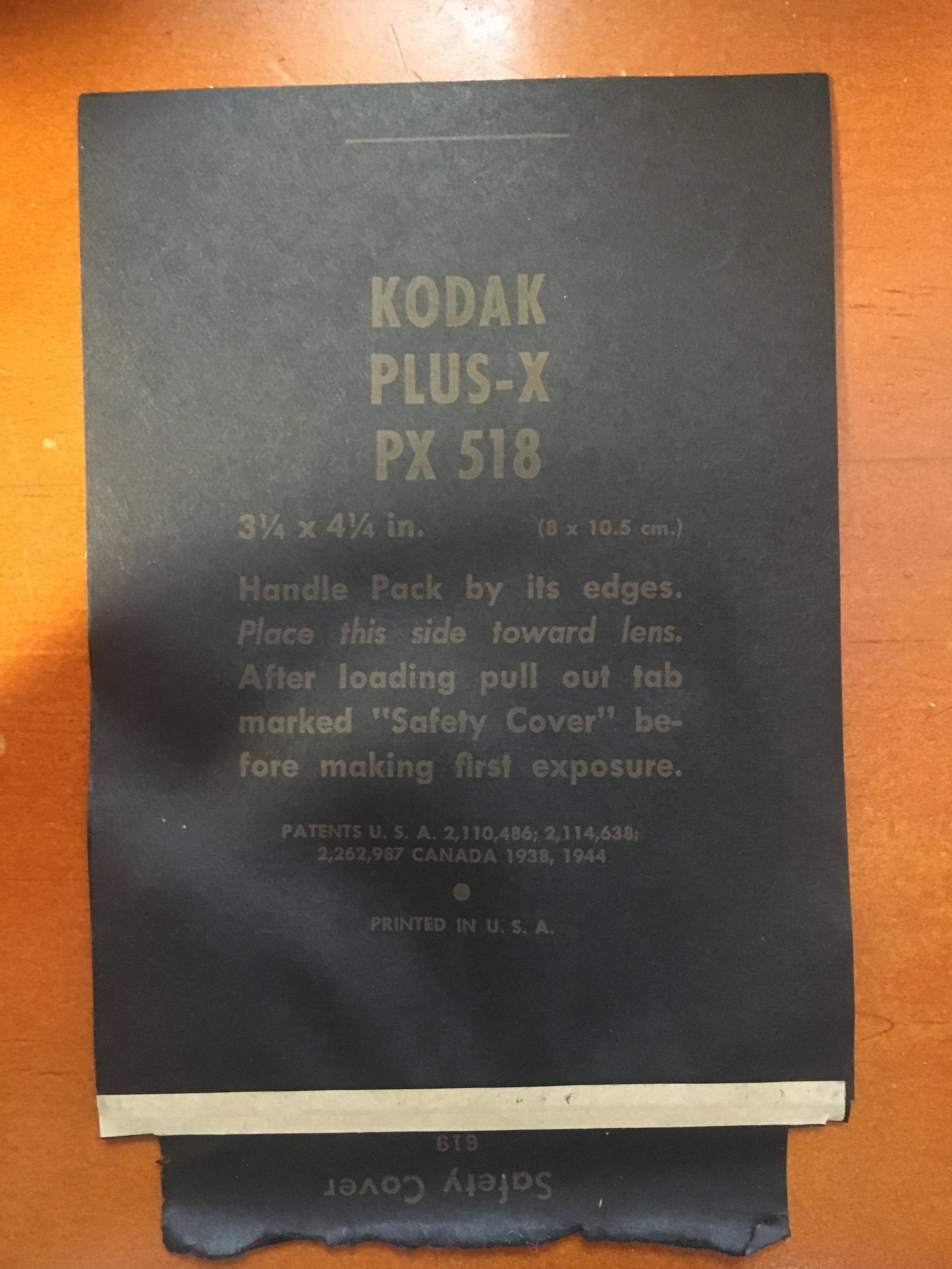

Until then, here’s a shot of the first-use instruction sheet I found inside the pack. Maybe we can figure out how old it is. I notice the last patent date is 1944; perhaps that helps.
