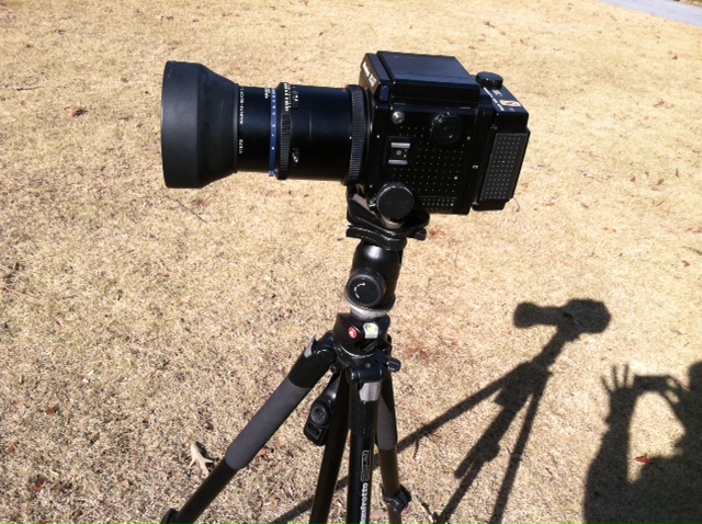

Here is the Manfrotto 055XPROB with the 488RC0 ball head holding my Mamiya RZ with a 180mm lens. Plenty sturdy. It's been a reliable performer for over four years.
