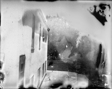

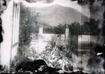

Results

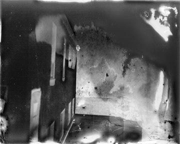

Hello to all, Everyone is gonna laugh at me because the scans of my plates are so uglt. But the plates themselves look much better. To coat the plates I used a 250 micron wire coating rod. This produced a wet coating 10mils thick. That is too much. I'll be getting a new rod that will lay down 7-8 mils. But it ain't here yet. Most of the obvious flaws, gaps in coating etc., are do to my clumsiness with wet plates and an IR monocle. Makes everything look thurther away than it is.. I have attached two negatives and the formula wth procedure. The actual plates, either just dryed or processed, are very glossy and hard. They remind me of obsidien. The are difficult to scratch and impossible to gough I am gonna make a new batch, just like this one, and use Denise Ross's coating well and a coating rod to try to get a wet thickness of about 7 mills.
Note that I wash the dried plates, not the emulsion,as PVA will not set up at cold temperatures, like gelaten (think: murdered cow,mother of baby calves:wink:
Bill

Well, that brings hand held shooting in the picture, 1/128th of a second at F2 :laugh:
The coatings are messy, but they look promising. Well, what do I have to tell, with zero experience coating plates...
Anyway, I hope you don't mind, but I took the liberty to "turn your negatives into positives" (with a thanks to MurrayMinchin here on APUG for making me see this differently, see the (there was a url link here which no longer exists)), as I was curious to see a bit better what was there.

Bill, there is nothing to laugh about your results. They really look promising!
As for the PVA, once dried-hardened, and when you soak the plates in the chemistry for processing, do they swell considerably (visibly)?
How long does it take to dry the plates once processed (I know there are many factors)?
thanks for sharing!

Here is a big difference between this emulsion and every gelatin emulsion that I have worked with. The PVA emulsion stays hard through all cold-water processes. I had no problem when I washed the dry panels in cold water for 3 hours. The one exception is at some corners and edges, where the film was so thick that it had not dried fully. I have always been a putz with a coating rod, even in daylight. Under IR I am worse. But flat dry areas do not buge.
After I removed the plates from the final rinse, I left them alone for 2 hours. But I think that an evenly coated plate would be dry in less than an hour.

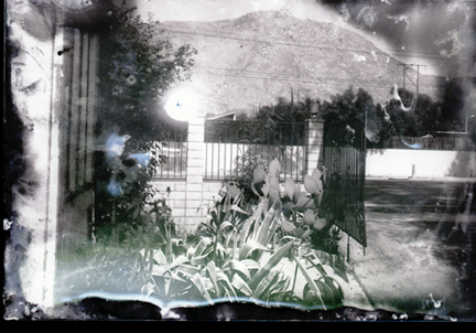

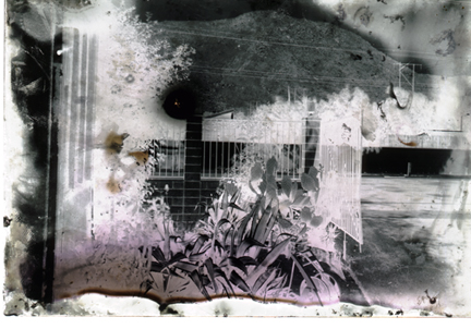

Another Batch of Experimental Emulsion

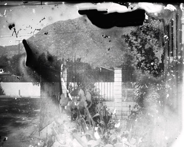

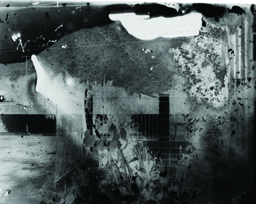

Hello to All,
I have evaluated another batch of emulsion based on Kuraray R 1130 instead of gelatin
The two changes in the emulsion were: A reduced polymer leval. This batch of R 1130 is 14% instead of 23% in the last emulsion. B) NH4I instead of KI
All glass plates were coted with emulsion using a modified glass frame and a #40 wire coating rod;Wet thickness 8 mils; Dryed 24 hours; washed for 3 hours;dryed overnight
I have a dewetting problen. As of now the emulsion contains no surfactant or alcohol. Tonight, I will coat more plates with this emulsion + surfactant. I am convinced that this is a dewetting issue and not an issue of frilling or lifting of emulsion.

Note that there are :whistling: red flowers arouned 10:30 o'clock.
Final rinse-1 houer

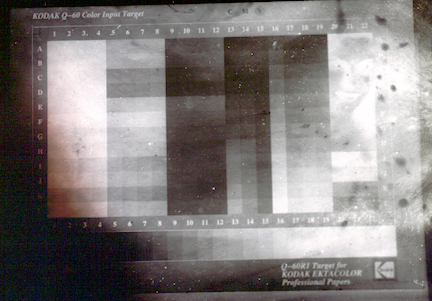

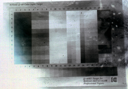

Colior sensitivity of Experimental Emulsion

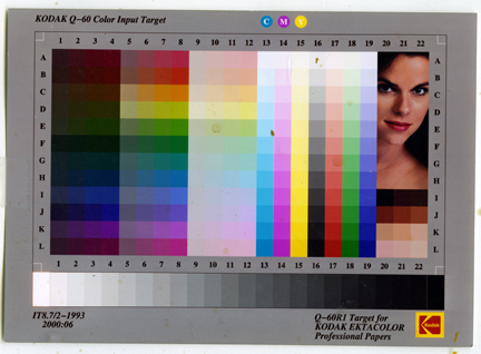

Hello to All,
I wish to make an emulsion suitable for color separation work. I took a shot of a Kodak chart in mid-day clear sunshine. Bellows factor was 2.3;F11;one second exposure. Developed as usual.
Bill;
Your blue speed is way above red. Green is in the middle kinda. In fact, the blue is greatly overexposed I think, compared to the other two.
PE
PE,
Do you think that simply uping the dye adition would sufice? I mean, with a fresh batch, not just adding dye to the existing batch..
Bill
Yes, it probably would hellp, but remember that sensitizing dyes are also antifoggants and you can therefore lose blue speed and overall contrast.

These balances look really, really close, Bill. I'll have to borrow those night vision goggles of yours and give it a try with gelatin!
Your gray scale looks good (accounting for the variations in density with your coating) and on the second column from the left, at the bottom, the relative values of the magenta and blue look very close. If I had to identify one area that needed work, it might be the greens, but really excellent all-in-all. Congrats! Once you get a coating protocol that is manageable in dead darkness, you'll have it made :smile:.
