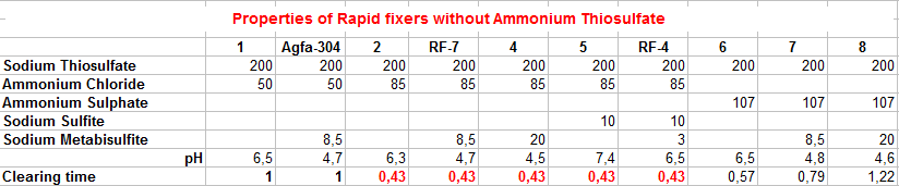

There are some formulas that use these these two that may be of interest.

Old Agfa formula #304
Water 750ml 52°C
Na Thiosulfate 200 grams
NH4+ chloride 50 grams
Potassium metabisulfate 20 grams
Water t make 1 liter
Use undiluted. Film 3 X clearing time, Paper 3 to 5 minutes.
Do not use any chemical with the word "SULFATE" in it in a fix. It slows down fixing and washing.
This is a general rule.
PE

Look at that table above and try to rethink your ideas about the times. There are some pretty bad results in the right hand of the table.
PE
PE
