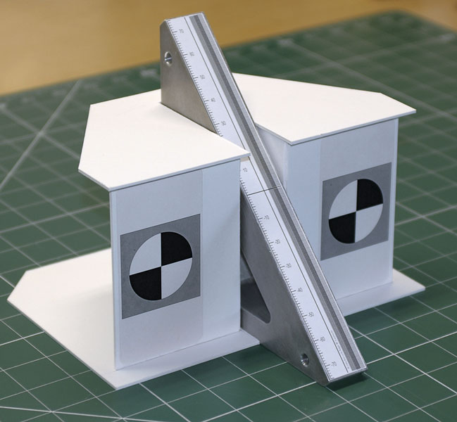

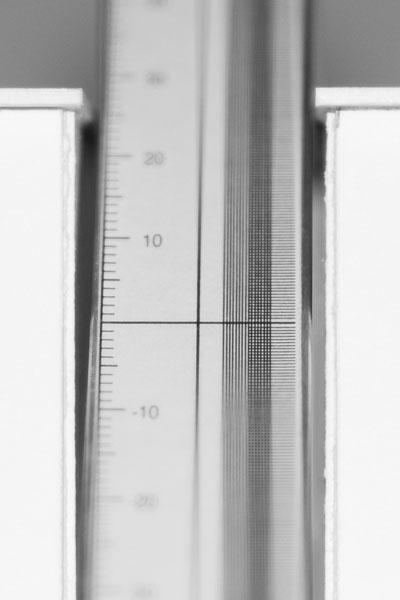

John
If you can, make yourself a focus target such as the one attached. It does not have to be that elaborate, just something to focus on and to measure the results. This will tell you if your camera is OK or if it needs an adjustment.
